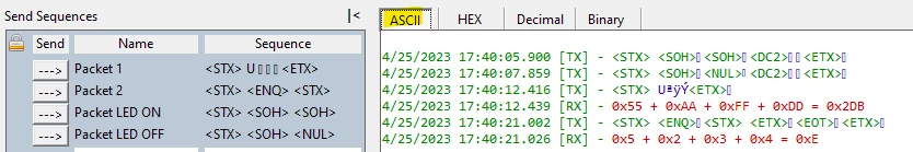

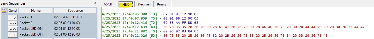

So based off some of your requirements, I just redid the code to look at UART2 for data that is 6 bytes and has the SOT and EOT (0x02 and 0x03) bytes to be considered a valid packet. Then I add the 4 bytes in between and send the total as a string to UART1 which has a loopback. That string that gets looped back is sent back on UART2. I also look for a specific packet that controls the LED on/off state.
Blue data is just binary data
_legacyfs_online_stmicro_images_0693W00000biou0QAA.pngRed data is the string

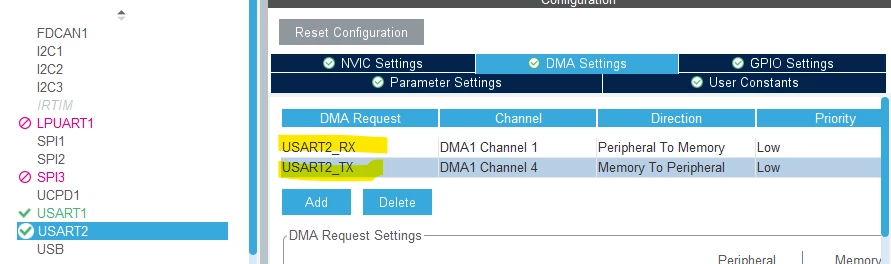

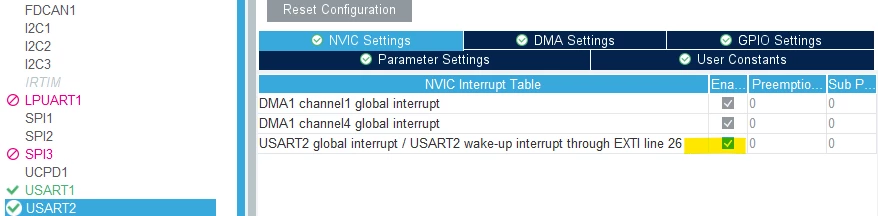

Be sure to enable DMA Tx/RX for both UART ports as well as enable the NVIC interrupt for the UART.
