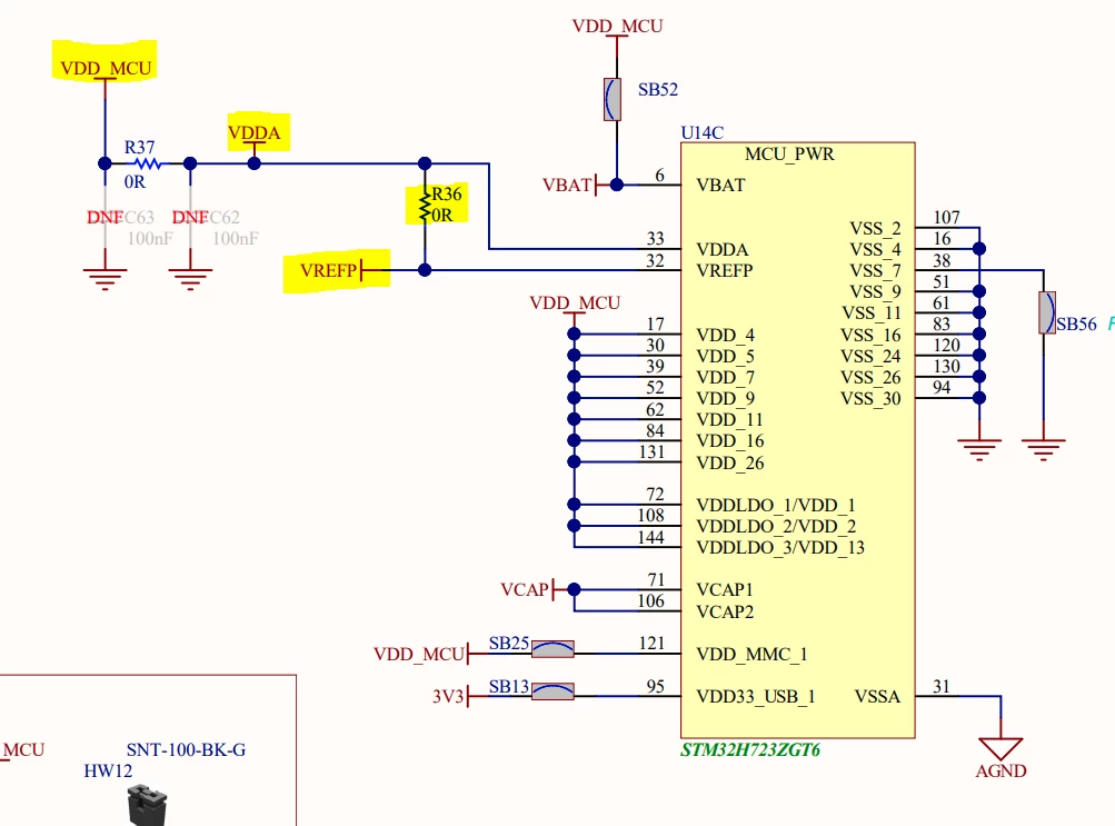

How are VDDA, AGND and VREFP connected to the MCU-Pins on NucleoH723ZG?
Hello everyone,
I am using the NucleoH723ZG board and I'd like to use the internal reference voltage for ADC-purposes. Initialising the VREFBUF...

...the code gets stuck in the while-loop. (The clock is also enabled for VREF) Is it possible that this is not intended using the Nucleo Board? I wonder how the VREFP signal on the Nucleo board is connected to the Microcontroller (respectively to the VDD?). Unfortunately I couldn't found the answer in the user manual of the nucleo board.

Schematics for all boards are available as well.
https://www.st.com/en/evaluation-tools/nucleo-h723zg.html#cad-resources
Connecting 2.5V to 3.3V clearly isn't going to work.

Thank you TDK! I didn't know the schematics are available online...
Removing R36 should be enough, am I right? Would it cause any trouble?
May 3, 2021 2:17 PM UTC
Seems like it would work. Looks like there are already external caps on that line as well, which are required.
