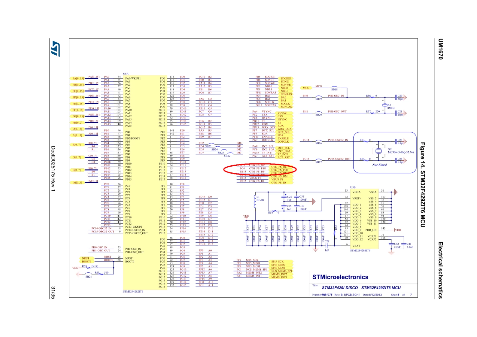

Hello. I'm developing an application based on Discovery board with stm32f429I.
And now I have quite a weird issue:a high signal level is shown on unconnected input pins.
Here is a code:
//Configure PC4 = input
#define GPM_IN((uint32_t) 0x00000000) /*GPIO_Mode_IN*/
#define GPb048
#define GP_HiSpd((uint32_t) 0x00000003)/*GPIO_High_Speed*/
GPIOC->MODER=(GPM_IN<<GPb04);
GPIOC->PUPDR=( (GPIO_PUPDR_PUPDR4_1) );
//((GPIO_OTYPER_OT_4));
GPIOC->OTYPER=0;
GPIOC->OSPEEDR=(GP_HiSpd<<GPb04);�?�?�?�?�?�?�?�?�?�?
I have tried different parameters of pullup and pulldown resistors, referring the following:
http://www.electronics-tutorials.ws/logic/pull-up-resistor.html
https://electronics.stackexchange.com/a/50641
but the issue persists, IDR4 bit shows '1' in debugger, while I'm expecting it to be 0. Strangely, but a similar configuration works OK for other ports. I have checked in debugger, nothing rewrites PC4 configuration, MODER4 is 0 as it should be. I suppose that for GPIO input I should enable pulldown resistor because it linksinput to Ground, which is believed to be as source of zero and use push-pull mode, because StackOverflow answer states that opendrain mode is used with pullup resistor...
How to correctly configure GPIO for input?

    The resistors on the board does not know what are you using in your project, they are always there.

    Well, I'm not using USB OTG FS in project, and PC4 is not configured with alt function, only as a generic input.
