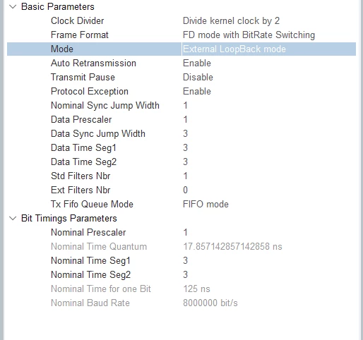

Hi, i'm dealing with fdcan and have problems with high speeds, 1Mbps works good, but 8Mbps (which works in loopback mode) doesn't, I tried with delay compensation, but didn't work, or maybe i used it wrong way?

Nominal bit time Should not exceed 1Mb/s. Only Data phase could reach 8Mb/s for STM32 MCUs.

Does it mean that only DATA in the frame goes with 8Mbps and other with 1Mbps?
mƎALLEm
February 14, 2024
Yes.
Nominal phase: max 1Mb/s
Data phase: max 8Mb/s: this is for STM32. Also it depends on the transceiver bandwidth you're using.
