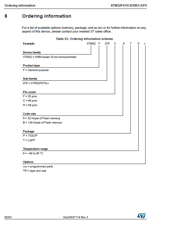

Hi What is the difference between STM32F070CB and STM32F070CBT6TR ? Ie what does the last 4 characters mean? Cannot se this in datasheets.. Thanks Kalle

Actually, you can find each character signification of the device name in its Data Sheet:
0693W00000KbxEBQAZ.pngThus, the T refers to Package, 6 to the Temperature range and TR to options.
I hope that I've answered your question.
Khouloud.

Many thanks Khouloud!
I don't know why the datasheet i downloaded is missing this, guess it was some downloadproblem!
