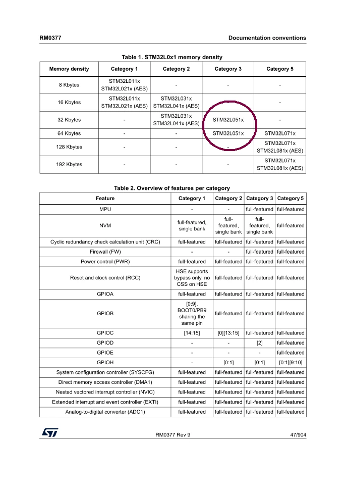

Hi, The RM0377 manual refers to device 'category'. How do I find which individual part numbers belong to which category? eg: -What category is a STM32L051K6T6? Thanks

waclawek.janBest answer
January 25, 2022
0693W00000JNBmwQAH.pngJW

Thank you very much guys. Obviously, I couldn't see the forest through the trees :grinning_face:

Actually, I was thinking the same when I posted it: that it's a bit unfair to RTFM you, given that table is REALLY hard to notice.
