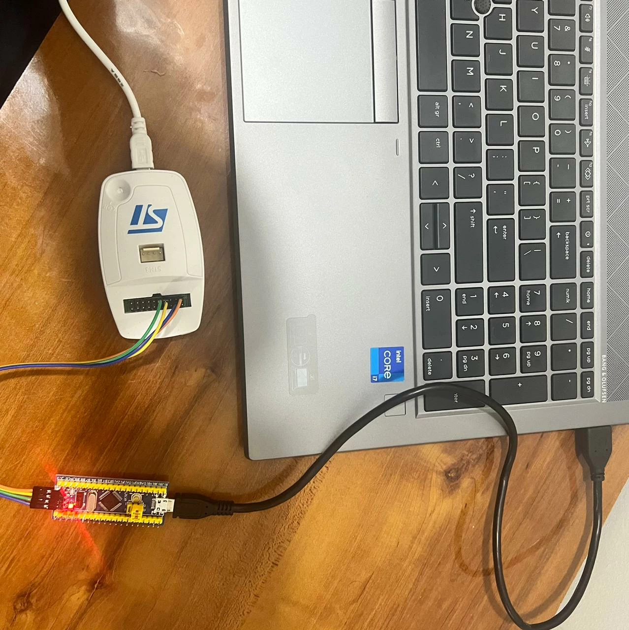

As I am working keil and the below function but keil shows a warning
(warning: implicit declaration of function 'simple_decimal_string' is invalid in C99 [-Wimplicit-function-declaration])
  1. char *simple_decimal_string(unsigned int x) // convert 32-bit unsigned to decimal string
  2. {
  3. static char str[16]; // Enough to hold 10 digits and NUL
  4. char *s = str + sizeof(str);
  5.
  6. *--s = 0; // NULL at end, working backward
  7. do
  8. {
  9. *--s = '0' + (x % 10);
  10. x /= 10;
  11. }
  12. while(x);
  13.
  14. return(s);
  15. }
Then I started working on CUBE IDE.
In which I am facing a problem my code programmed in mcu but controller does not response like nothing burned in it.
I am using STM32F103C6 controller.
I am using ST-Link/V2 probe for programming.
Even I tried a simple blinky programme but it does not work.
I am using Debugger setting as OPEN OCD mode and software reset.
For led blinking I did following setting in CUBE MX.
Used SYS as serial wire
GPIO as output PC13 for led.
Using ext osc.
I wrote code simple for toggling led status.
HAL_GPIO_TogglePin(GPIOC,GPIO_PIN_13);
HAL_Delay(500);
So you used the function earlier in the code than the definition/body of the code?
jtron.1
jtron.1AuthorBest answer
September 24, 2022
Hi DeLorean.!
I am very happy to say that my code is working now.
Thank you so much tesla. This happens only with your guidance.
I also thanks to ST community for this platform.
Grateful.....!!!!!!!!!!!
Thanks a lot tesla again.
Actually I was declaring function body/definition not in the same file.
However, it is working.
