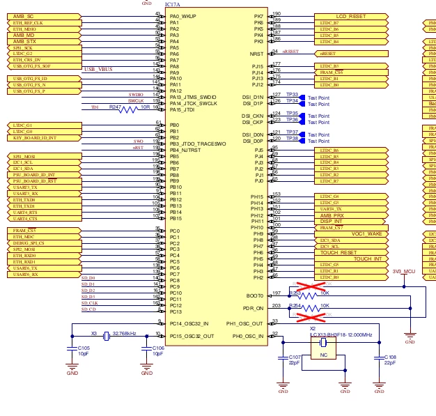

Hi Mam/ Sir, I am using STM32F779 MCU in that OSC(RTC) clock is not working(output wave not coming), so please suggest any hardware & software settings needed I attached schematic
  • May 24, 2021
  • 10 replies
  • 4465 views
For OSC i am using 32.768khz and caps 10pF, but output is not coming. so please give me suggestions for hardware & software chages to work 32.768khz clock work.
10 replies
Tesla DeLorean
Guru
May 24, 2021
What's the crystal part# ? Is it a 6, 9 or 12 pF crystal? Capacitors calculated per Application Note?
Should be able to walk-in the LSE enable via RCC/PWR register bits. Should be able to route the LSE clock via MCO1 / PA8 to measure without loading the circuit.

Crystal Part: CM315D-32.768KDZC-UT
Please share cap values to above crystal part for hardware changes.
Tesla DeLorean
Guru
May 24, 2021
Surely you should be able to run your own numbers?
I'd perhaps try 4.7pF or 5.1pF
Run a simple application to enable the clocks, and plumb the output to the MCO1 (PA8) pin.

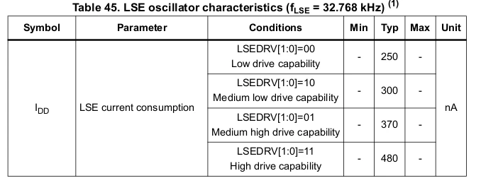

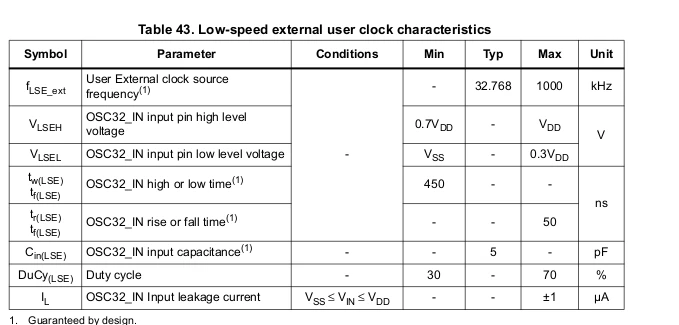

Hi Tesla,
I mounted 5pF CL caps still not get proper clock on crystal. Please suggest need software configurations required images attached.
Pkuma.41
Pkuma.41Author
May 26, 2021
Clock internal resistance setting required ?

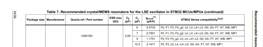

May 26, 2021
In datasheet recommended cap table
Pkuma.41
Pkuma.41Author
May 26, 2021
STM recommended crystal used on my board: CM315D
Part in application note(AN2867)
