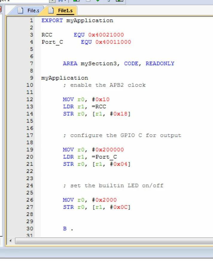

Im New to the stm32 products , Also to Cortex M3 ,Im using the stm32f103 mcu ,programming it on Keil ,In Assembler ,So i got this basic program to output on port C.
