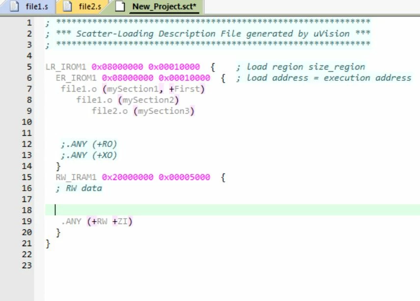

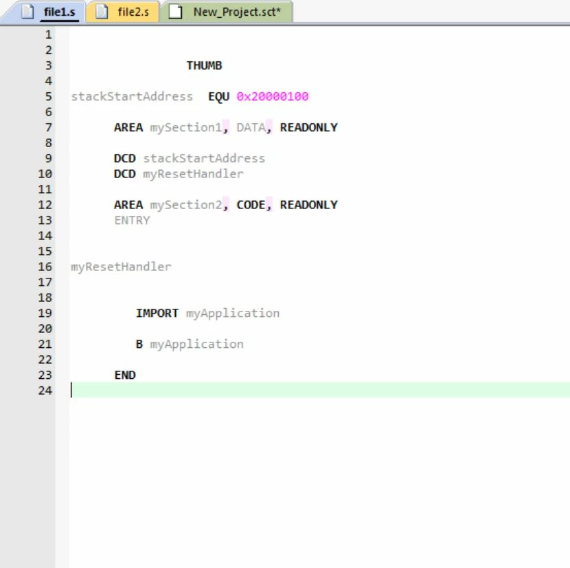

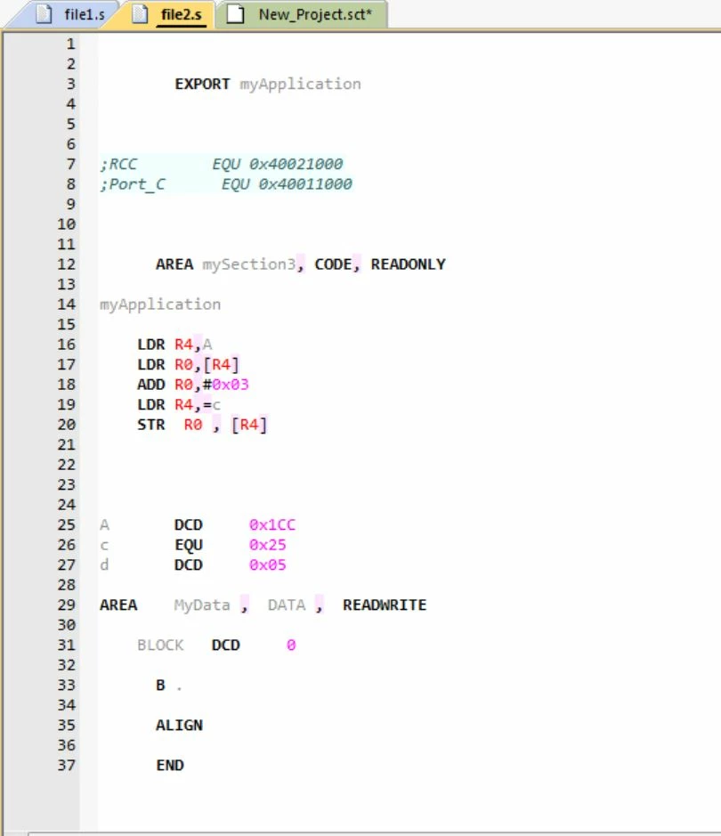

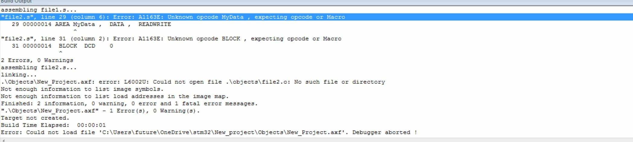

Hi, I want to load my value into the SRAM by using the command STR , So I declared a READ-WRITE section in file2 but it always gives me a build error, I'm using the stm32f1 series.I believe this has something to do with the scatter file .
Ive also tried reading the linker documentation but didnt understand much.

Tesla DeLorean
Tesla DeLoreanBest answer
Guru
Aug 2, 2020 12:04 PM UTC
can't edit screenshots
AREA needs a space in front, where as BLOCK does not, assembler sensitive to line position of labels vs keywords.​

Yes Thankyou @Community member​  I forgot about line position.The code runs now
