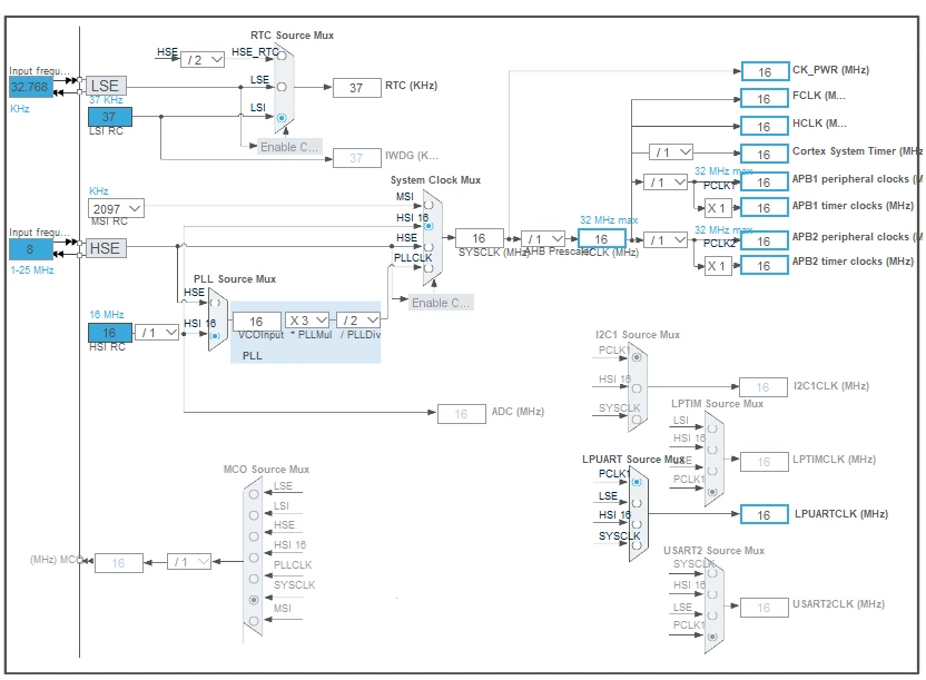

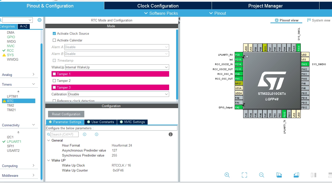

Hi. I've included the code below. I want to pause for 10 seconds in standby mode. The code works once and never returns. And there is no serious drop in Ammeter. What could I be doing wrong?

The problem was the boot0 pin. Connecting the boot0 pin to gnd with a 1k resistor solved the problem. StandBy works.

As first you need reconfig stlink to no debug in low power mode and turn off power to mcu .
After this flash code (no debug) and measure.Current must drop.
Second stage is wake up... read examples in firmware lib folder.
