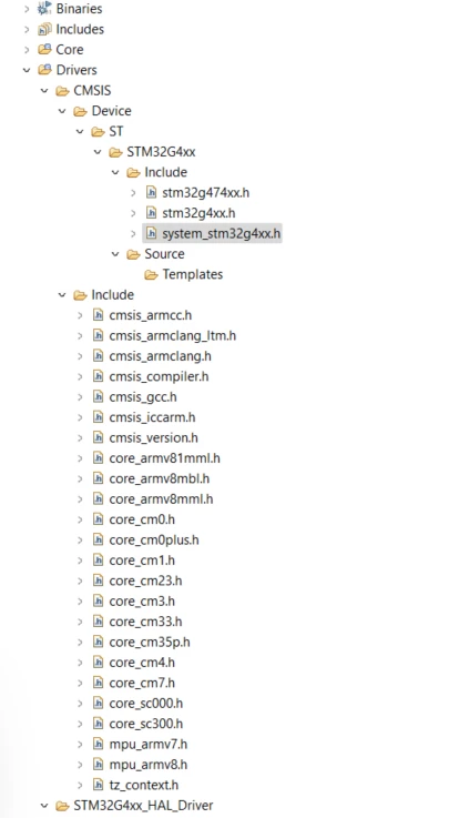

Hi, I need to implement a PID controller on my Nucleo board STM32G474RE, is there any developed library for this particular controller or resources available that help me to implement the PID controller?

The G4 has the same CM4F floating point unit, the CMSIS directories for the DSP code/example should be in CubeG4 repositiory.
Not sure there's PID examples, but it's not exactly rocket science.
I'm not even sure the integer example is particularly helpful.
Arduino has some PID libraries, if you need examples, and perhaps range checking, but I think at this point reading a College Level theory book might be more helpful.

Thank you for your response. If you don't mind me asking where can I find CubeG4 repository or CMSIS directories with DSP code?
I searched within my project's folder structure and within that, I could not find it.
