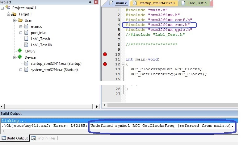

Hi! I'm trying to build a project with rcc_getclocksfreq function. Linker return error L6218e: undefined symbol. Where is my error? keil uvision 5.36 STM32F407VG

Include .H files do NOT bring in library code, you need to add the actual library .C source files into the project tree.

The "Undefined symbol" error means that your application does not include object, source or libraries including this function.
Make sure that your project contains all the required library source files.
As advised by @TDK​ , you can take a working example and check configuration and implementation, then compare the code/functions with yours and make updates according to your needs.

Sorry for being late. I solved the problem quickly. Thanks to Tesla DeLorean and his advice:
"Include .H files do NOT bring in library code, you need to add the actual library .C source files into the project tree."
