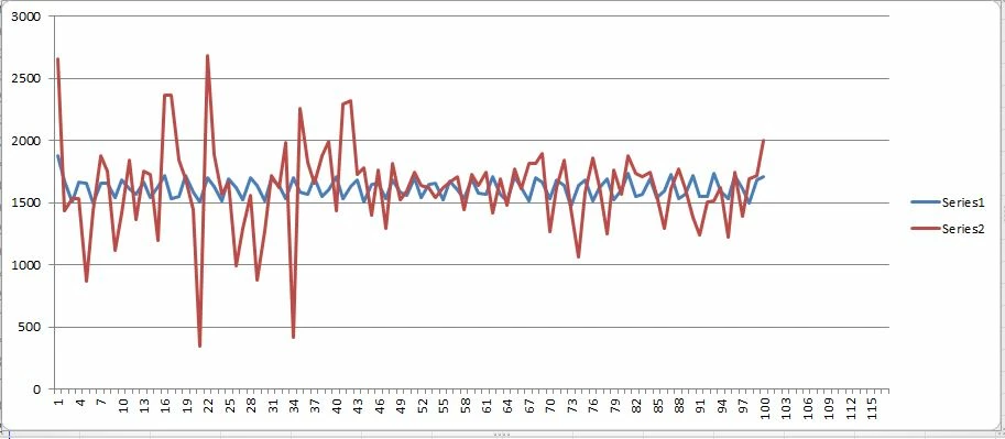

Hi I am working on the ADC peripheral of STm2 f401re board, I am unable to obtain a good signal for greater than 10khz. Can you please help me with the same

raptorhal2
Lead
May 27, 2019
Clairvoyancy is not common.
You need to describe the input signal, the code being used, whether or not the conversions are being transmitted in real time through a USART, and use descriptive labels in the graph.

VRagh
VRaghAuthor
May 28, 2019
Sorry for being very abstract. I am finding trouble in plotting analog signal. We are getting good signal upto 10khz after which we are getting spikes for higher frequency. The signal is a sinusoidal signal. The converted signal are stored in memory and then transferred through UART.
Here is the code attachment

raptorhal2
Lead
May 28, 2019
Check my math on this. The ADC clock is 12 MHz, conversion takes 18 clocks, the sample is averaged over 8. Add a bit of code time and the max sampling rate is about 75 KHz. At 10 KHz signal that is 7.5 samples per signal cycle. The results will look choppy at higher signal frequencies.
The sample cycles time is very short. What is the signal source impedance?
