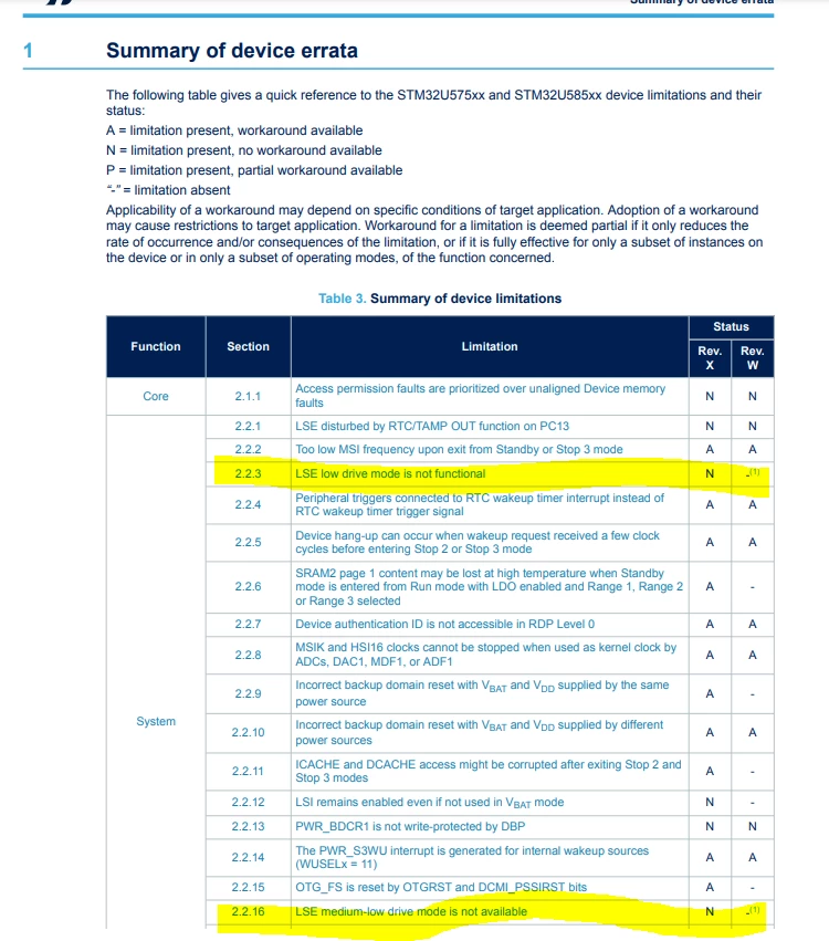

In the errata sheet,it is mentioned that low drive mode and medium low drive are not working.. but I checked and they work fine...is there any correction in the errata sheet...?..Can I go with low drive mode for LSE (NUCLEO-U575ZQ)???

It's depend on your microcontroleur revision.
If you have an Rev W , low drive mode and medium low drive are working. But if you are using a revision version older than this one, they don't work.

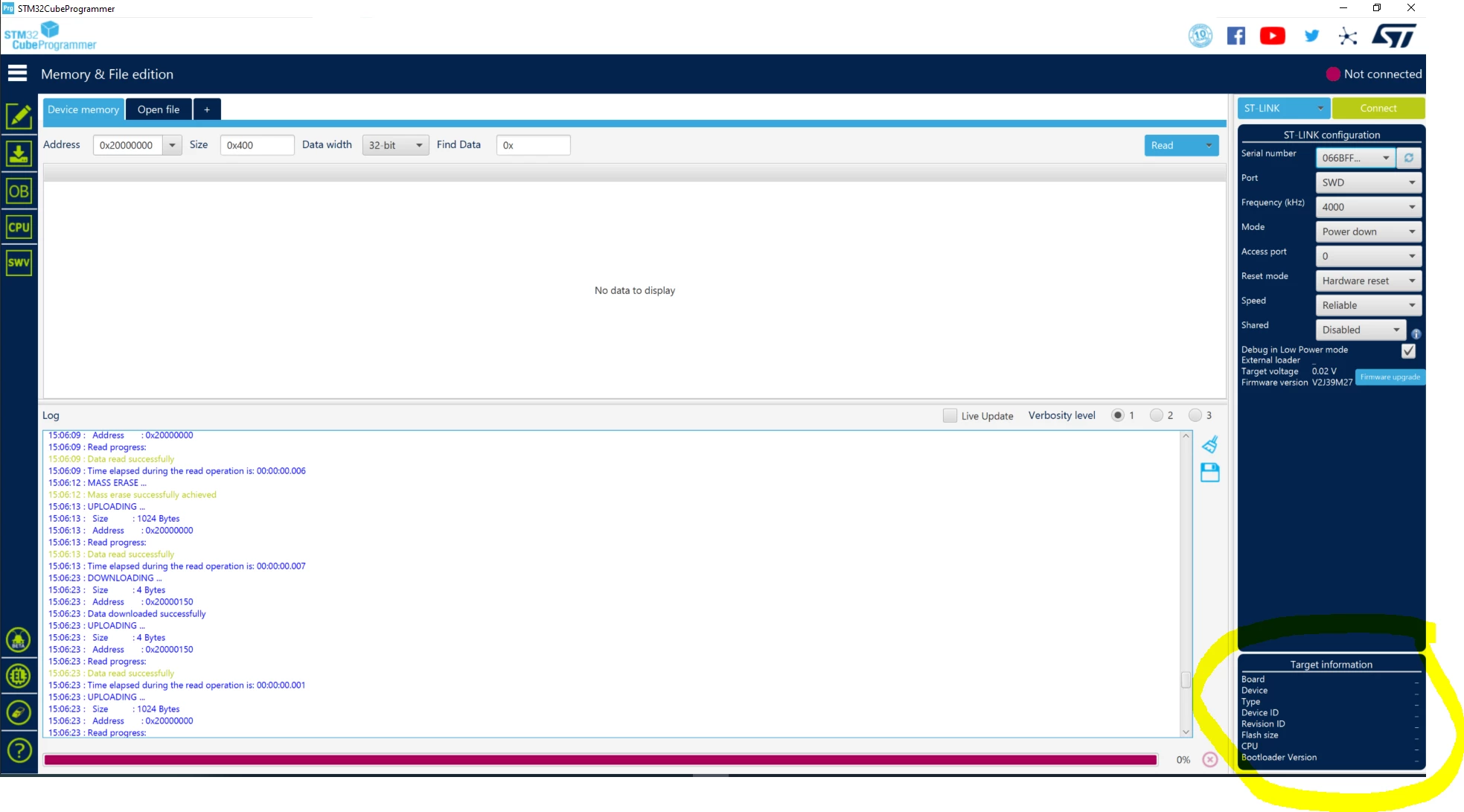

May 2, 2023
You can check this information by using STM32C ubeProgrammer, in target information , you will find it .
_legacyfs_online_stmicro_images_0693W00000bjBWpQAM.pngRegards
DianeP

Thanks ,
i confirmed, It is Revision X.not W...but all modes are working....
