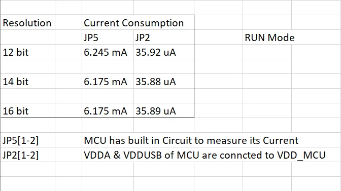

Hi, I am using STM32L4P5 discovery kit to find out current consumption in different ADC configuration, i.e 12 bit, 14 bit & 16 bit resolution achieved using oversampling. May I know why the current consumption is same in different ADC configuration
  • November 29, 2022
  • 5 replies
  • 2138 views
0693W00000WJhn2QAD.pngAbove table shows the observations made. I would like to know if there is any internal architecture of MCU which is governing same current consumption.
I have attached code snippet for 14 bit configuration.

> HAL_Delay(1000);
This results in effective sampling rates of 1Hz to 256Hz in your case. At these rates the difference will be entirely negligible and dominated by the VDDA overall consumption and leakage

Can you elaborate more on effect of current consumption on different ADC configuration (12 bit, 14 bit & 16 bit achieved by oversampling) ??
S.Ma
Principal
November 30, 2022
Well if you take 2 samples and make an average to get one more bit, the adc current remains constant. The current over time would be a better measurement unit....

The ADC is using the same hardware therefore the same current to sample each of the 3 configurations. It just takes longer for 14 and 16 bit resolutions.
Edit: Table 77 in the data sheet make no mention of current for different oversampling resolutions. If your question is derived from Table 78 Maximum ADC Rain, please read AN2834 "How To Get The Best ADC Accuracy in STM32 Micros" for understanding.
