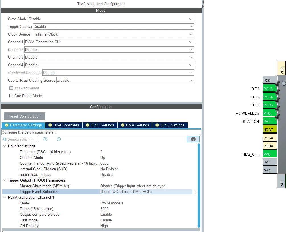

Hi, I am using STM32L010C6 and I'd like to generate a PWM signal on PA0.
 I have configured the peripheral with STM0693W000005B931QAC.pngCube, as shown in the picture, but I have no output signal on the pin. I can see the TIM2_CNT is working and the CCR1 contains the coorect value

And the firmware use the instructions:
MX_TIM2_Init();
HAL_TIM_PWM_Start (&htim2, HAL_TIM_ACTIVE_CHANNEL_1);
but nothing happens on the pin. If I simply configure PA0 as a output push-pull it works, sothere are not hardware problems.

Hi, I made the correction you suggested but the result is the same.
I tried to change the setting of PA0 to open drain with pull-up but it still does'nt work and remains low.
Instead loading the PWM Output example for STM32L053 nucleo boards it works very well. I have checked that the configuration made in the example is slightly different from the code generated by MX.

Read out and check/post TIM and relevant GPIO registers content.

Hi, I think I found the bug, the generated code of the PA0 did't comprehend the setting of alternate function, see the code as it was generated:
oid HAL_TIM_MspPostInit(TIM_HandleTypeDef* htim)
 if(htim->Instance==TIM2)
 /* USER CODE BEGIN TIM2_MspPostInit 0 */
 /* USER CODE END TIM2_MspPostInit 0 */
  __HAL_RCC_GPIOA_CLK_ENABLE();
  /**TIM2 GPIO Configuration
  PA0   ------> TIM2_CH1
  GPIO_InitStruct.Pin = GPIO_PIN_0;
  HAL_GPIO_Init(GPIOA, &GPIO_InitStruct);
 /* USER CODE BEGIN TIM2_MspPostInit 1 */
 /* USER CODE END TIM2_MspPostInit 1 */
The raw:
GPIO_InitStruct.Alternate = GPIO_AF2_TIM2;
was missed.
