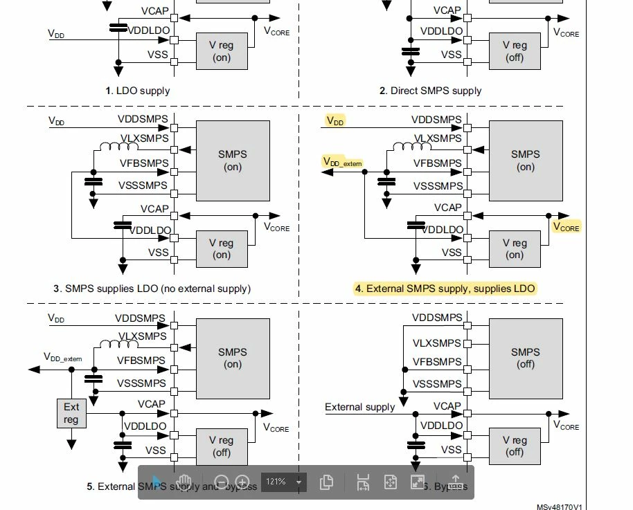

Hi, I am trying to use STM32H745XI in my design, I have some doubts in the power supply section in the reference manual en.DM0017687!
  • September 9, 2019
  • 0 replies
  • 1139 views
I am trying us STM32H745XI controller in my design, I want some clarification in the power supply section. In Reference manual en.DM00176879->section 7.Power control (PWR) ->Figure22->4.External SMPS Supply, Supplies LDO. I am not understanding how the external SMPS output which connects with internal SMPS output. Please clarify is it connects to Internal SMPS output or Direct External SMPS output connects to the LDO and Vcore.
I am attaching the section which i have doubt and reference manual which i am referring to
