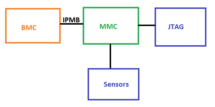

Hi, i am checking IPMB Supported MCU(MMC) Which should able to communicate with BMC Please advice

    Welcome, @MKuma.9​, to the community!
    IPMB is based on I2C, so basically all STM32 are able to communicate with a BMC.
    Regards
    /Peter

    MKuma.9
    MKuma.9Author
    October 22, 2021
    With supported JTAG Is it possible access external SoC JTAG ? Or its only for MCU Debugging purpose ?
    My application is used to access SoC JTAG from BMC Through MMC By using IPMB-I2C.

    Peter BENSCH
    Peter BENSCHBest answer
    October 22, 2021
    As you probably know, JTAG was originally developed for testing boards/assemblies, and debugging was added later. In your case you need a JTAG host to access a JTAG slave, which is usually not implemented in microcontrollers.
    To answer your questions: The JTAG port can only be used for debugging and testing the STM32. You could try implementing a JTAG host with bit banging, but it's not an easy task.
    Good luck!
    If the problem is resolved, please mark this topic as answered by selecting Select as best. This will help other users find that answer faster.
