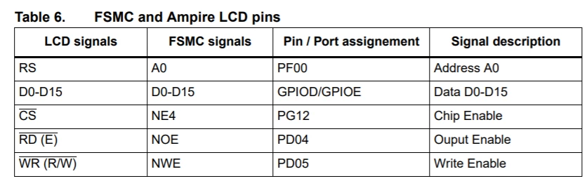

Per the link, you need to study the documentation to work that out.
You titled this thread, "8080-MCU" - did you really mean that? Looks like you're talking about an LCD - not an MCU?
