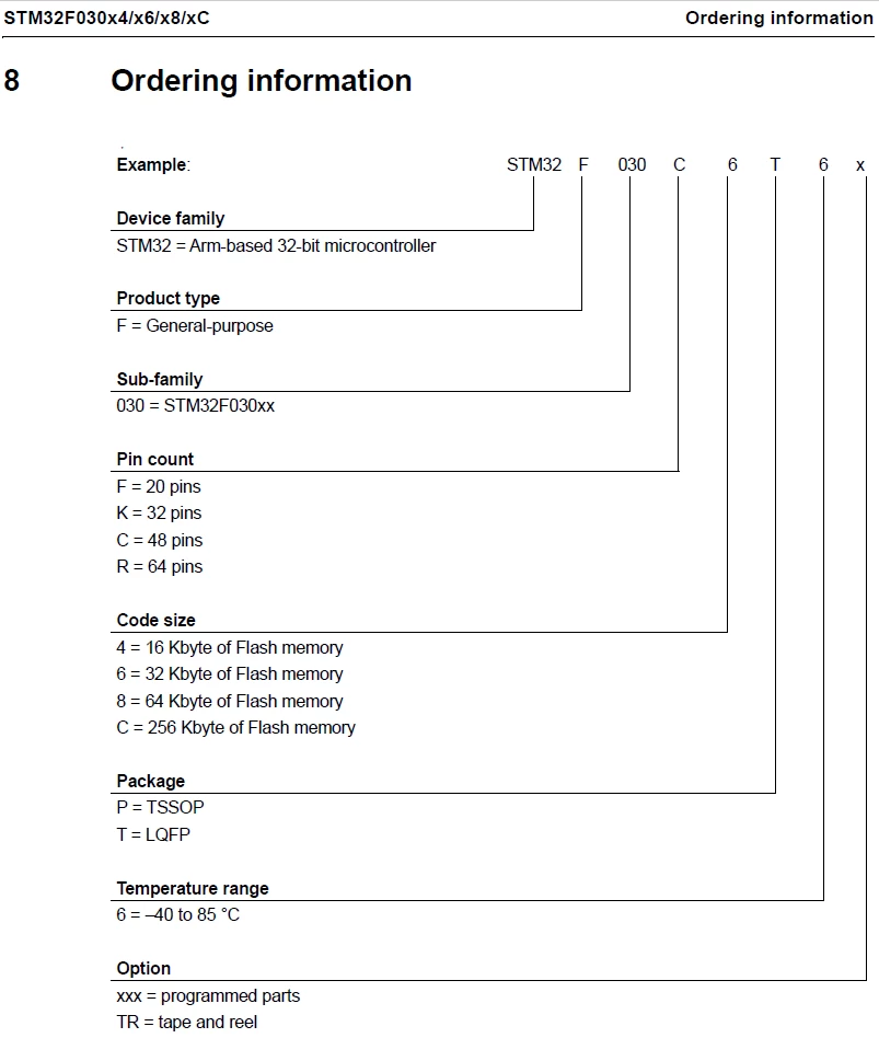

Did you mean STM32F030x8?

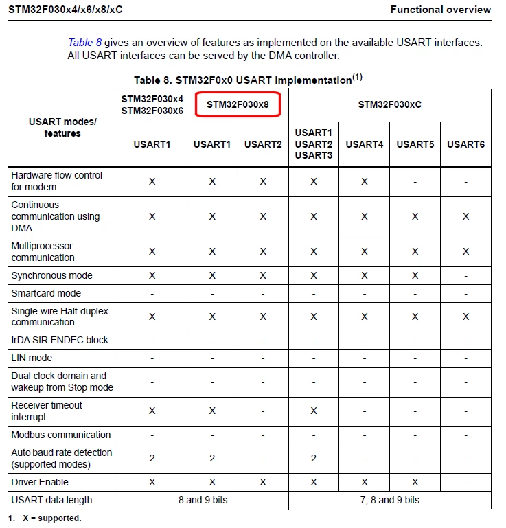

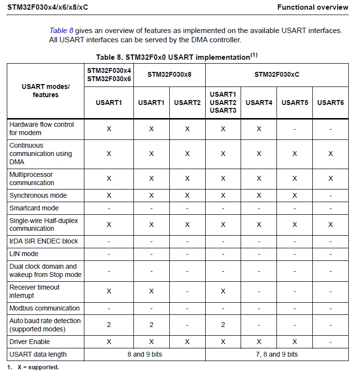

Datasheet has no mention of any hardware FIFO for the USART:
0693W00000QKw6GQAT.pngSo you'd have to implement any FIFO (aka "Ring Buffer" or "Circular Buffer") in software.
Since it's in software, it wouldn't be specific to the STM32 - there are plenty of general resources on implementing circular buffers
