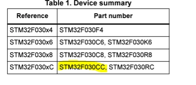

I am using custom board with controller with part number given below
SSRIN.2
SSRIN.2Author
July 28, 2022
as i am using stm32f030cct6 in my custom board, in this two controllers are used with same part number.
