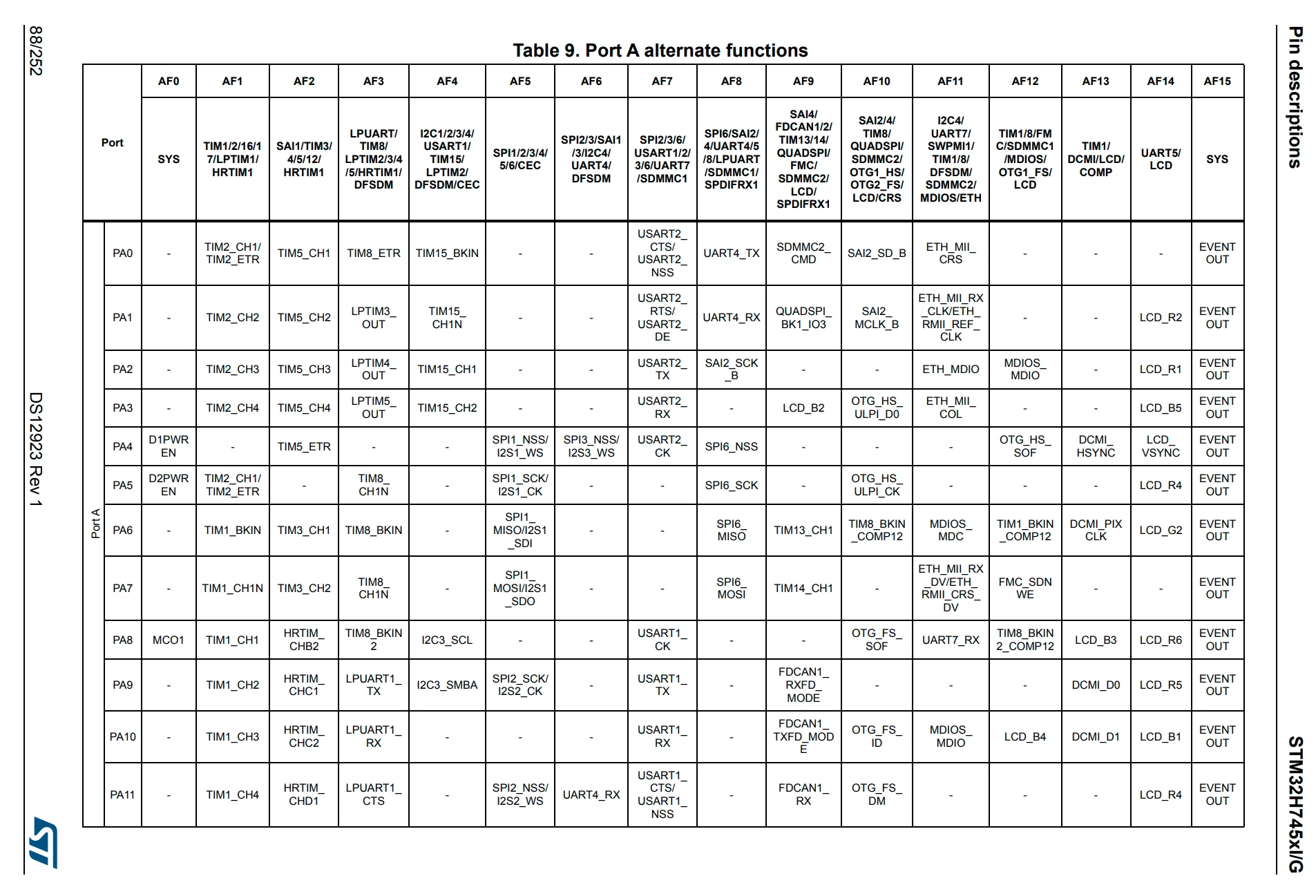

Hi, does anyone know where I can find a table of alternate pin functions for an STM32H745? It seems to me that the manual lists the functions of each pin, but does not provide the value to set on GPIO_AFR for each function. Thanks
TDKBest answer
December 20, 2021
The datasheet will have that information.
https://www.st.com/resource/en/datasheet/stm32h745zg.pdf
For example, here is port A:

Thanks a lot, I've walked over it a thousand times without seeing it.
