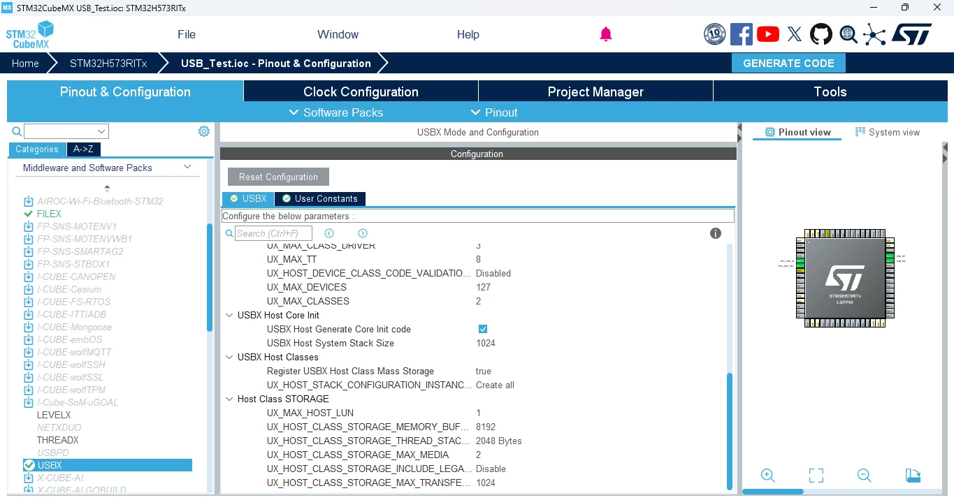

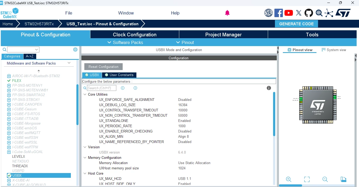

I'm currently working on a project using the STM32H573RIT6, and I’m relatively new to this STM32H5 series. I’m trying to implement a USB MSC (Mass Storage Class) host using USBX with FileX, and I’m using STM32CubeMX for configuration and STM32CubeIDE for development.
Importantly, I’m working without any RTOS – this is a bare-metal (standalone) implementation, so I'm not using ThreadX or any other RTOS.

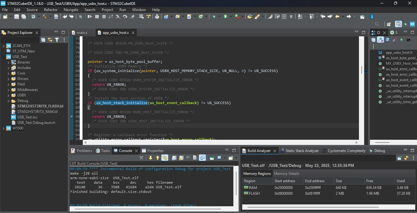

However, I'm encountering an issue during the USBX host stack initialization. Specifically, the function ux_host_stack_initialize() returns UX_ERROR, and based on debugging, it appears to be related to insufficient memory allocation.
Here’s what I’ve done so far:
  • Using default USBX and FileX settings in STM32CubeMX.
  • Enabled USB in Host mode and selected the necessary middleware components.
  • No RTOS selected in the project.
  • No changes to heap/memory sizes so far.
I’ve attached a few screenshots of my CubeMX configuration and relevant code snippets for reference.
Has anyone experienced this issue on the STM32H573 when using USBX & FileX without an RTOS?
  • Do I need to manually increase the heap or configure memory pools differently?
  • Any recommended memory allocation settings changes for USBX/FileX in standalone mode?
  • Are there specific considerations for USB MSC with USBX on STM32H5 without ThreadX?
Any advice, example projects, or tips would be greatly appreciated!

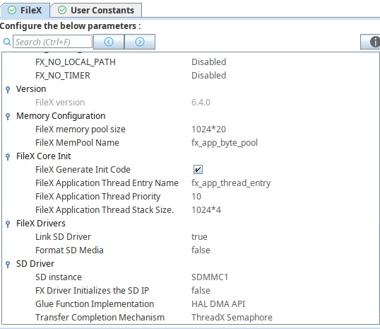

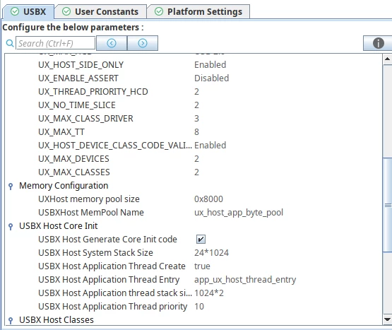

AScha.3
May 26, 2025 5:00 PM UTC
yes, i think so. I just tried on H563ZI running USBX & FileX with Azure...but same: does not work "out of the box" .
And it needs a lot of memory...rtos or not, makes no difference, i think.
So make the memory pools big....until its working, then still can try to reduce, to find out, whats needed.
I give you my settings, so try :
usbx:
