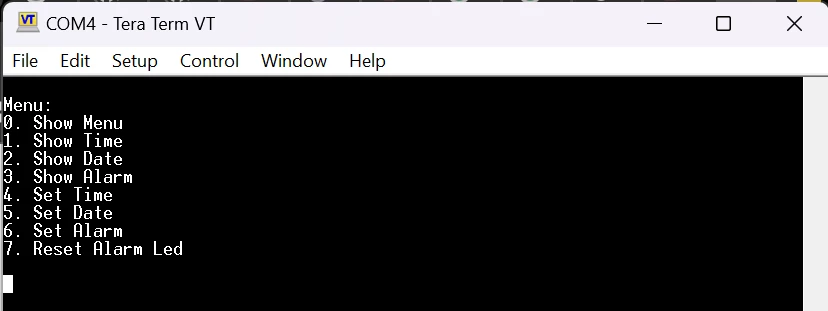

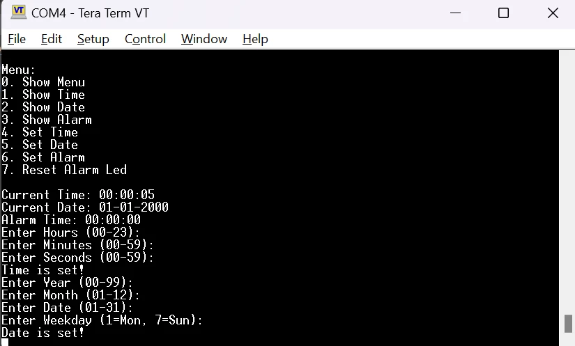

Nov 7, 2024 10:13 AM UTC
Hello all, (EDITED)
With some debugging i've got the code to work without any errors, everything is working fine on the OLED Display,the only problem is if I am coommenting out this line:
void HAL_TIM_PeriodElapsedCallback(TIM_HandleTypeDef *htim)
 if (htim->Instance == TIM3)
 // Your 1-second interrupt handling code here
 	Print_Date_Oled();
 	Print_Time_Oled();
which is used to display the time and date on the OLED, the Terra Term does not work and there is no feedback when pressing any keys while trying to change the date and time.
The above is showing like this when trying to press any key on the num pad.
But actually it has to be like this.
The above happens when I commenting out the Print date and time function.
So either I am able to use the RTC functionality or miss displaying it on the OLED, or I am able to Display on the OLED missing RTC functionality.
The video for the same can be found here https://www.youtube.com/watch?v=Nm-16YhCYl8&t=1438s
Github for the same original project is located here: https://github.com/PRTechTalk/STM32/tree/main/G071_LCD_RTC.
Can you please check.
Thanks and Regards
