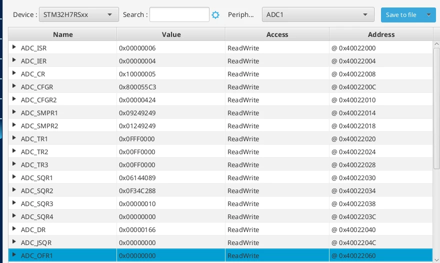

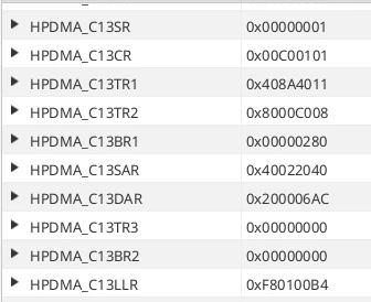

I've been trying to get DMA to work on the STM32H7S3L8 with bare metal code. As far as I can tell, I have everything set up correctly(?). I get no DMA error flags. The DMA complete flag is never set and the target buffer remains empty.
I have enabled 10 ADC channels and have set it up to trigger from a timer. This works fine without DMA, and the ADC EOC interrupts fire. I have toggled a GPIO in the ADC conversion complete interrupt handler which switches as expected, and clear the end of conversion flag also in the handler.
Both GPDMA and HPDMA work fine with software triggered memory-memory transfers. I suspect there is either something preventing the ADC DMA request from reaching the HPDMA or something to do with how the trigger is configured. I do not wish to have a separate trigger, just transfer when there is ADC data ready.
Both DMAEN and DMACFG are set to 1 in ADC1_CFGR, and these are the ADC register contents:
These are the DMA register contents :
The following are the bits set in the DMA registers:
  • CR : EN, TCIE, Priority of 0b11
  • TR1:
    • SDW_LOG2 : 0x1 (2 bytes)
    • SBL_1: 0x0 (single)
    • SAP: 1 (AHB Port)
    • DDW_LOG2: 0x2 (4 bytes)
    • DBL_1: 0x0 (single, though I do want to increase this later)
    • DAP: 1 (AHB Port, writing to DTCM)
  • TR2
    • REQSEL: 0x08 (adc1_dma)
    • TRIGM: 0x3 (trig for every burst, though this should not matter)
    • TRIGSEL and TRIGPOL : 0x00
    • TCEM : 0x2 (TC for every LLI)
  • BR1: BNDT 0x0280 (640 bytes. 10 channel * 32 samples * 2 bytes each)
  • SAR : 0x4022040 (ADC1 DR)
  • DAR: Start address of buffer in DTCM

I seem to have it working. I don't quite know why it was not. SBL and DBL were originally not actually 0 (single), instead they were 1 and 4.
Once they were changed to 0 and 0. There is some ADC data now appearing in the buffer, though it seems inaccurate at present. It also immediately caused a buffer overflow and nuked a number of additional variables. By changing the size to 20, the memory corruption is removed and I think I now see that the size calculations are incorrect.
