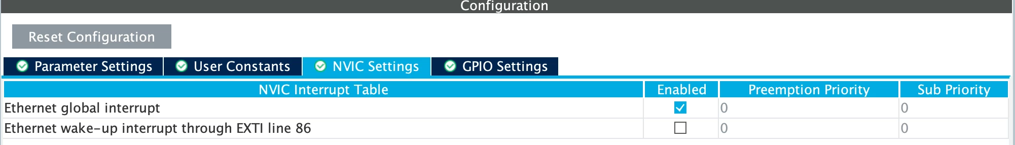

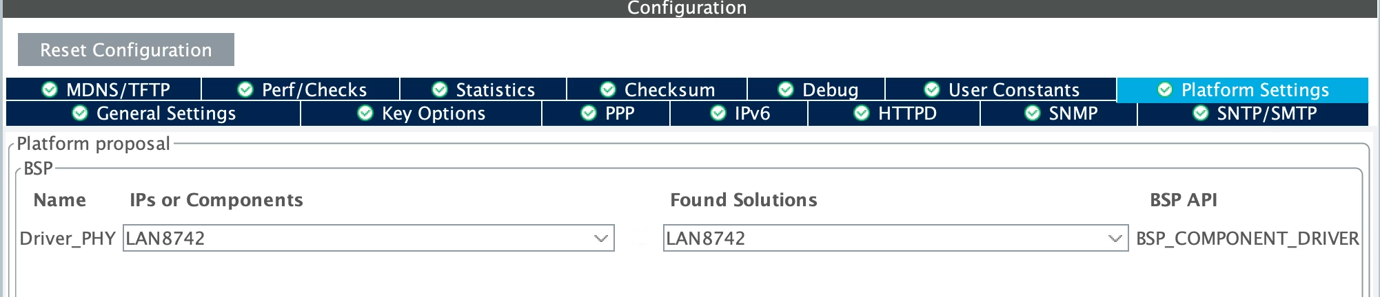

Hi all!
I have been using a F446RE board to communicate with an encoder using SPI. I get back a 16-bit value every ms (the process runs at 1kHz). However, I now need to transfer the acquired data over ethernet (it has to be ethernet, not UART or another communication, as it goes through a switch) to a computer in packages ~once per second. I bought an H723ZG board because it comes with a ethernet port, but I have been having a lot of trouble setting up ethernet, as I have had very little prior experience with it.
I have researched more into how ethernet works, and tried the following things:

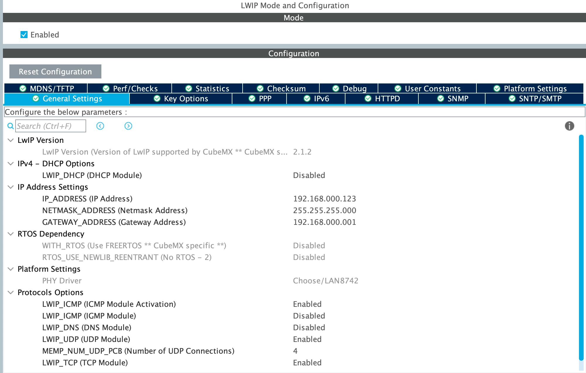

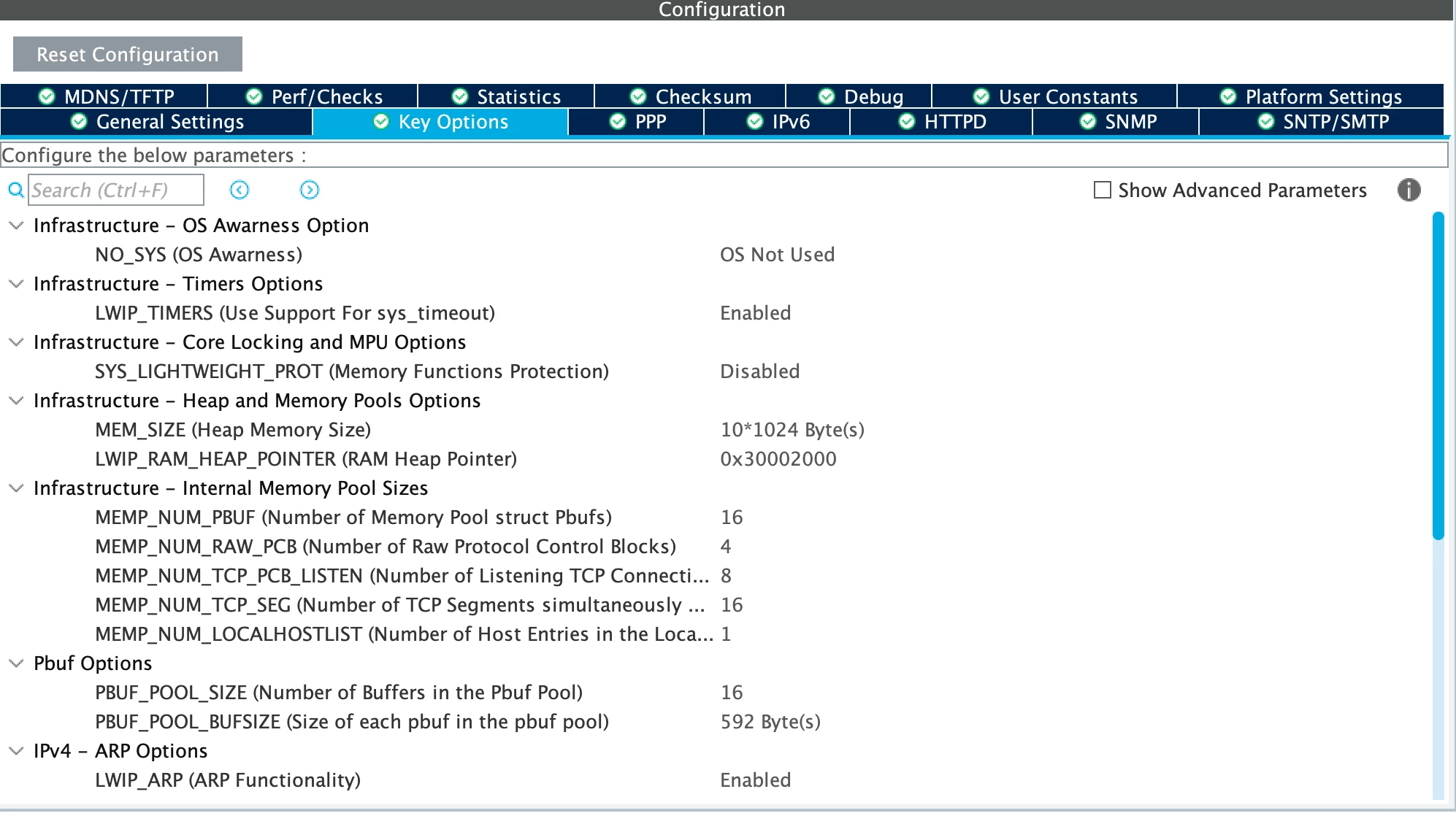

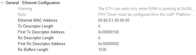

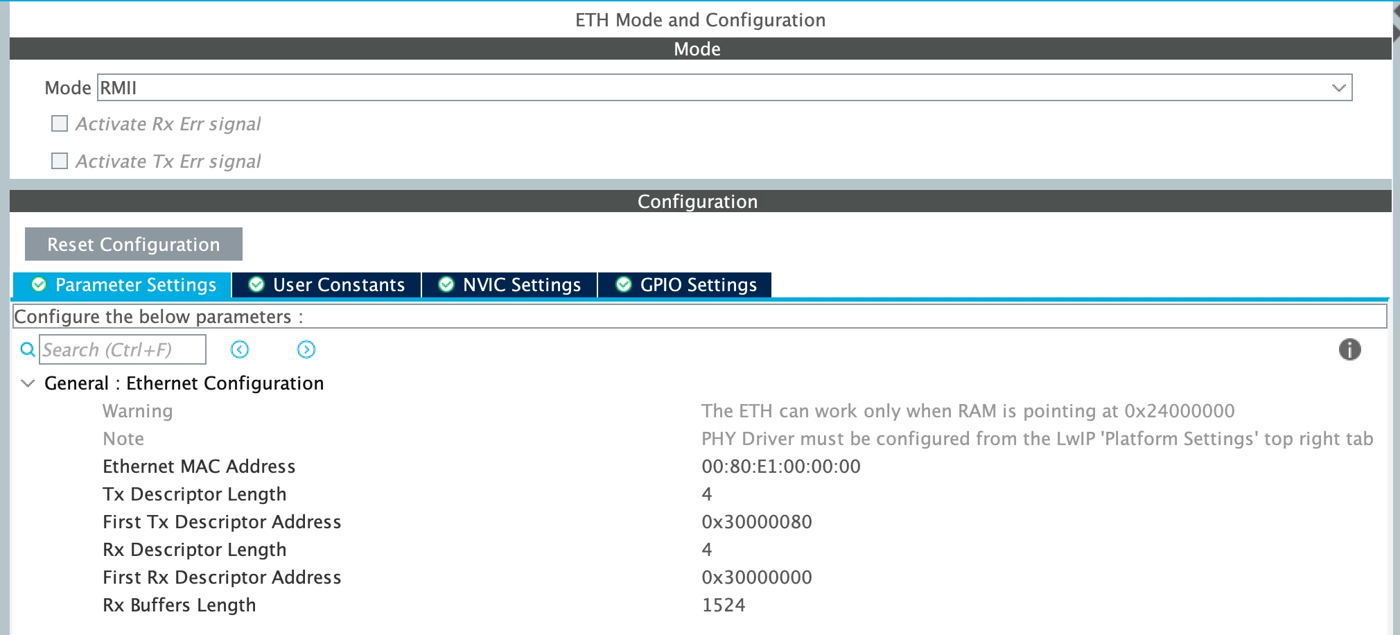

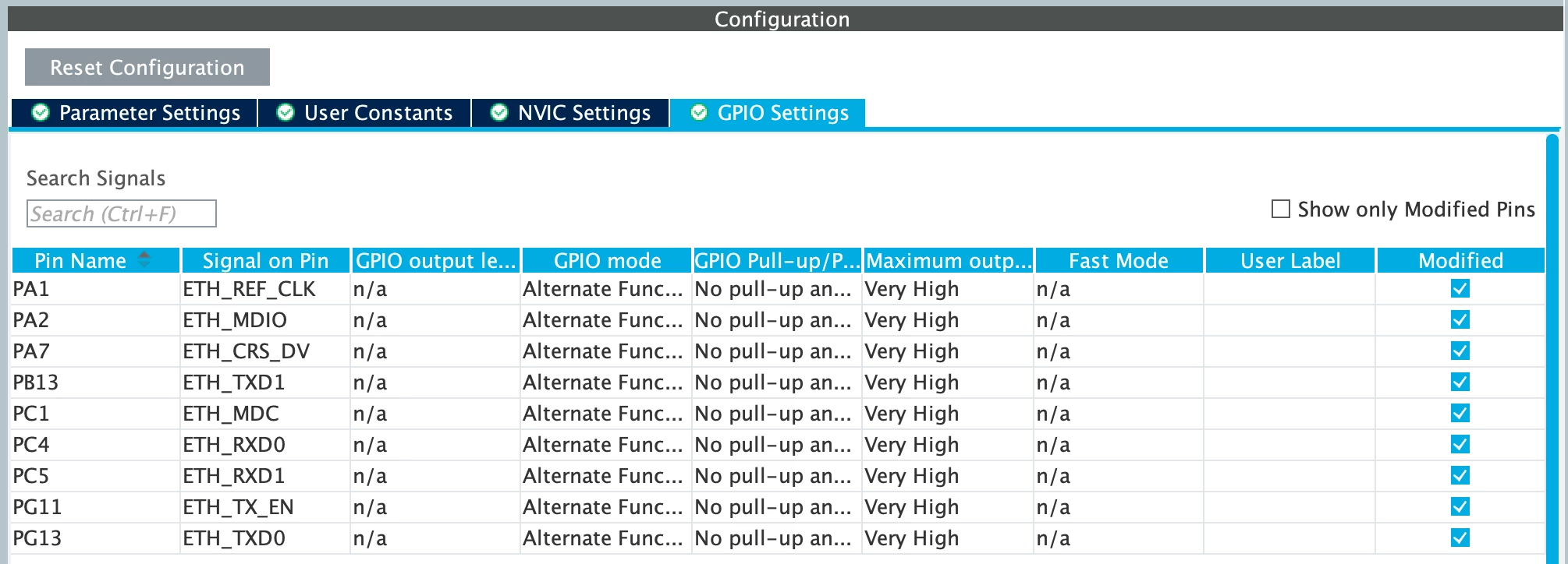

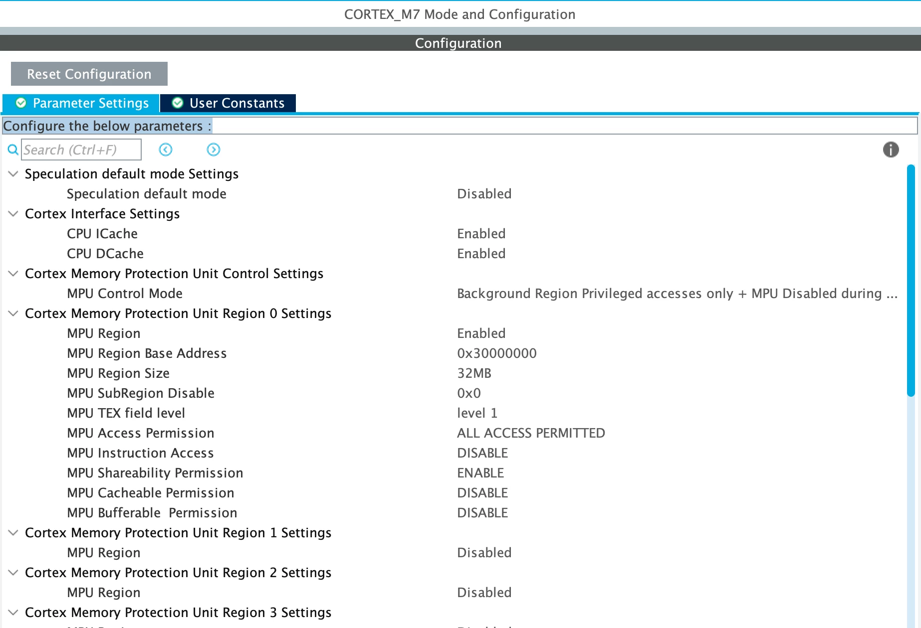

1. I followed this tutorial, with the difference that I changed "RMII_TX_EN" to PG11 and "RMII_TXD0" to PG13 as per the schematic for my board. I set up my CPU, ETH:First Rx/Tx Descriptor Addresses, and LWIP:Ram Heap Pointer as per the video (respectively, 0x30000000, 0x30000080, 0x30002000 for rx/tx/lwip ram heap). The code compiles and when I debug there is no hard fault, but I am unable to ping the device. I have my mac set to 192.168.000.030 and the device to 192.168.000.123 with subnet mask 255.255.255.000 and gateway address 192.168.000.001
2. I tried using the STM32 H723ZG example projects "LWIP_UDP_Echo" and "LWIP_TCP_Echo". When I turned off DHCP in lwipopts.h and set my mac to ip 192.168.000.030 and subnet 255.255.255.000 I was able to ping the microcontroller successfully, but I could not get it to echo using the command echo -n "Testing LwIP UDP echo server" | nc -u 192.168.0.10 7
I also spent a lot of time scrolling this community/stackoverflow/reddit, where a lot of people suggested giving up on LWIP and CubeMX and instead just using FreeRTOS + TCP. I am not very familiar with FreeRTOS although I understand the principles, and I have not coded an STM32 microcontroller using anything other than CubeMX or PlatformIO (Arduino). Furthermore, my code for communicating with the encoder/collecting data was written in CubeMX so I am hesitant to try and port it.
I am starting to get really confused and don't know what to do next, so I thought I'd make my own (first time!) post. I am really hoping someone could point me in the right direction:
1. For my (relatively simple) purpose, would you recommend continuing with LWIP/CubeMX or abandoning it and trying to use FreeRTOS.
2. If FreeRTOS is the solution, can this be easily implemented with CubeMX or do I have to use another software?

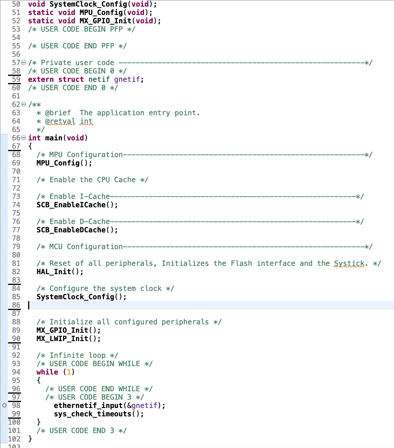

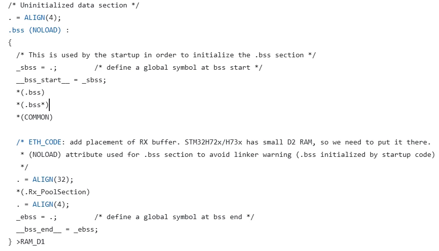

3. If continuing with LWIP/CubeMX is the solution, can someone point me towards what I might be doing wrong? I have uploaded screenshots of all the relevant configurations/code I used following the tutorial I linked.
4. Am I using the right board? I have heard lots of people complain about H7. Would my task be easier to accomplish on an F7?
Thank you all immensely for your help in advance!

This is my contribution: if you can share please your hardware setup I mean the schematics or which board issued and especially the PHY routing and clocks, we need first to eliminate any hardware issue and to run an exemple from the templates .

@shuyu_vk Note that ethernet controllers in STM32F4, STM32H7, F7 are different and the examples are not interoperable. Start from an example for a board similar to yours. Unfortunately most of these examples were made without CubeMX/IDE GUI support and do not have .ioc file.

April 2, 2025
I have implemented my project on Nucleo-H723 and it works perfectly. Below are the configuration:
MPU_InitStruct.Enable = MPU_REGION_ENABLE;
MPU_InitStruct.Number = MPU_REGION_NUMBER0;
MPU_InitStruct.BaseAddress = 0x0;
MPU_InitStruct.Size = MPU_REGION_SIZE_4GB;
MPU_InitStruct.SubRegionDisable = 0x87;
MPU_InitStruct.TypeExtField = MPU_TEX_LEVEL0;
MPU_InitStruct.AccessPermission = MPU_REGION_NO_ACCESS;
MPU_InitStruct.DisableExec = MPU_INSTRUCTION_ACCESS_DISABLE;
MPU_InitStruct.IsShareable = MPU_ACCESS_SHAREABLE;
MPU_InitStruct.IsCacheable = MPU_ACCESS_NOT_CACHEABLE;
MPU_InitStruct.IsBufferable = MPU_ACCESS_NOT_BUFFERABLE;
HAL_MPU_ConfigRegion(&MPU_InitStruct);
/** Initializes and configures the Region and the memory to be protected
MPU_InitStruct.Number = MPU_REGION_NUMBER1;
MPU_InitStruct.BaseAddress = 0x30000000;
MPU_InitStruct.Size = MPU_REGION_SIZE_32KB;
MPU_InitStruct.SubRegionDisable = 0x0;
MPU_InitStruct.TypeExtField = MPU_TEX_LEVEL1;
MPU_InitStruct.AccessPermission = MPU_REGION_FULL_ACCESS;
MPU_InitStruct.IsShareable = MPU_ACCESS_NOT_SHAREABLE;
MPU_InitStruct.Number = MPU_REGION_NUMBER2;
MPU_InitStruct.BaseAddress = 0x38000000;
MPU_InitStruct.Size = MPU_REGION_SIZE_16KB;
- Changes in linker file:
