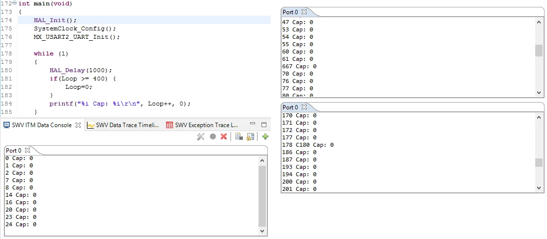

Help understanding mysterious lapses in printf() output via SWV Port 0 as shown in SWV ITM Data Console
0693W000008zqcuQAA.pngNotice how entire printf lines disappear and how occasionally just portions of printf lines disappear.

There are buffering issues within the pod

Even if I include fflush(stdiot); immediately after the printf, the problem is the same.

Well there are many layers that can cause this. From the ST-LINK firmware up to the host ST-LINK or OpenOCD server, to the CubeIDE (Eclipse) debugger client.
Has anybody seen these glitches with true J-Link adapters?
