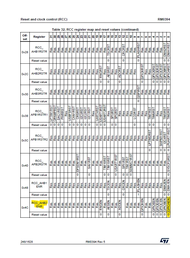

Help to use PA15 as GPIO Output on NUCLEO-L476RG
 I am a newbie with STM32. I need help.
I want to configure that PA15 pin (which by default is used as JTDI), as a GPIO output.
I've added the following two lines to the beginning of the generated code of MX_GPIO_Init():
LL_GPIO_SetAFPin_8_15(GPIOA,LL_GPIO_PIN_15,LL_GPIO_AF_5);
LL_GPIO_SetPinMode(GPIOA,LL_GPIO_PIN_15,LL_GPIO_MODE_OUTPUT);
But it does not work. I connected a LED and tried to change the state of the pin high and low,
but it did not work.
I appreciate if someone help me to figure out what I am missing.

@DZado.2 wrote:
I did two changes:
1) I removed the lines (as gbm proposed):
//LL_GPIO_SetAFPin_8_15(GPIOA,LL_GPIO_PIN_15,LL_GPIO_AF_5);
//LL_GPIO_SetPinMode(GPIOA,LL_GPIO_PIN_15,LL_GPIO_MODE_OUTPUT);
1) And I added
LL_AHB2_GRP1_EnableClock(LL_AHB2_GRP1_PERIPH_GPIOA);
in addition to
__HAL_RCC_GPIOA_CLK_ENABLE();
Now it is working. I have no clue why.
If I remove LL_AHB2_GRP1_EnableClock(LL_AHB2_GRP1_PERIPH_GPIOA), it does not work.
Would you please explain why?
I'm not sure? The LL and HAL are setting the same register/bit, though the LL is static inline
Look at the disassembly to see what each is doing.
// HAL
#define __HAL_RCC_GPIOA_CLK_ENABLE() do { \
 __IO uint32_t tmpreg; \
 SET_BIT(RCC->AHB2ENR, RCC_AHB2ENR_GPIOAEN); \
 /* Delay after an RCC peripheral clock enabling */ \
 tmpreg = READ_BIT(RCC->AHB2ENR, RCC_AHB2ENR_GPIOAEN); \
 UNUSED(tmpreg); \
 } while(0)
// LL
#define LL_AHB2_GRP1_PERIPH_GPIOA RCC_AHB2ENR_GPIOAEN
__STATIC_INLINE void LL_AHB2_GRP1_EnableClock(uint32_t Periphs)
 SET_BIT(RCC->AHB2ENR, Periphs);
 tmpreg = READ_BIT(RCC->AHB2ENR, Periphs);
 (void)tmpreg;

gbm
Dec 17, 2024 7:31 PM UTC
Is the GPIOA enabled in RCC? Setting AF is not needed, it's enough to set the output mode. You may do the same via CubeMX.

Karl Yamashita
Dec 17, 2024 9:11 PM UTC
Yes, either way should set the bit.
Which L4 are you using?
Are you using a Nucleo board or a custom board?

Karl Yamashita
Dec 17, 2024 8:11 PM UTC
You haven't indicated if you enable the GPIO clock?

Karl Yamashita
Dec 17, 2024 9:25 PM UTC
It seems you've added code manually. So have any peripherals been enabled that could be using that same pin?
