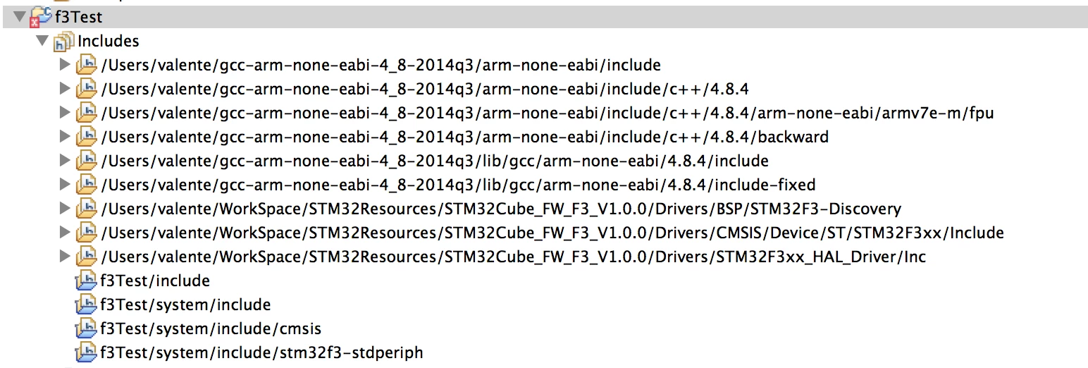

I'm very new to STM32, I recently switched from Microchip platform and I'm working on a Mac (which seems to make everything harder).
I followed this very nice tutorial
http://www.davidrojas.co.uk/stm32f3discovery-on-mac-os-x-using-eclipse-gcc-arm-and-openocd/
 which got me up and running with the blink example with the STM32FDiscovery.
Them I download the STM32CubeF3 and I'm trying to build the ''GPIO_IOToggle''example.
There is no Eclipse example and neither I know how to import (or if its possible), them I started a blank project with my toolchain, which just gave me a blank main file.
Them I add/replaced the .c and .h in the folders, when built I got a bunch of errors, because wrong paths I believe...
After adding paths, this is my actual config:
I've add
#include
<stdint.h>
#include
<stdio.h>To main.c
Now I'm getting this weird error:
/Users/valente/WorkSpace/STM32Resources/STM32Cube_FW_F3_V1.0.0/Drivers/STM32F3xx_HAL_Driver/Inc/stm32f3xx_hal_tim.h:1325:24: error: unknown type name 'TIM_TypeDef'
 void TIM_OC3_SetConfig(TIM_TypeDef *TIMx, TIM_OC_InitTypeDef *OC_Config);But the files are all included...
Any help is appreciated.
Greetings.
Renan

    th695
    Visitor II
    October 10, 2014
    Posted on October 11, 2014 at 01:13
    Have you uncommented the #define HAL_TIM_MODULE_ENABLED section in
    stm32f3xx_hal_conf.h?
