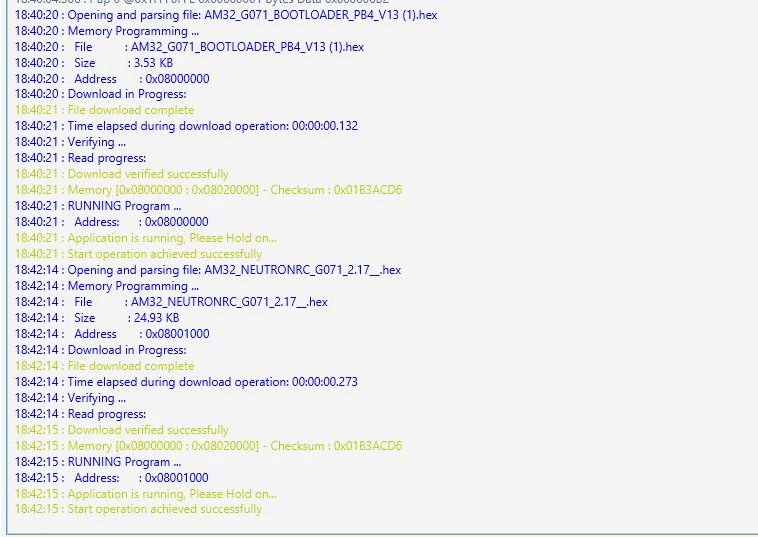

Help to identify the component
I need to know if this ST i'm using has been made by ST or is a clone
G071GB
GQ28L10
9RCHNB
.       323

AScha.3
Mar 13, 2025 9:27 PM UTC
Why you think, its a clone ?
What telling CubeProgrammer , after connect ? (show...)

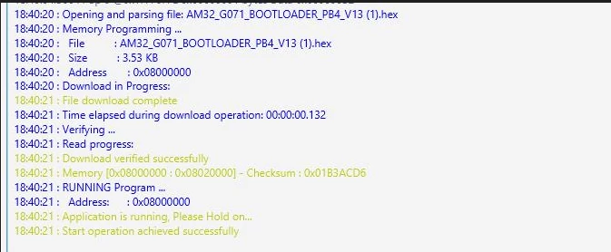

MtrevAuthor
Mar 13, 2025 9:44 PM UTC
This STM has strange functioning after an update, this STM is connected on an Eletronic speed controller and not working after updates.
I've attached an printscreen of programmer.
Tesla DeLorean
Guru
Mar 13, 2025 9:53 PM UTC
You'd need to work with the vendor more directly to understand if this is the correct firmware, applied appropriately.
You could dump/inspect the FLASH via STM32 Cube Programmer, making sure it's got the binary data, and hasn't written the .HEX as ASCII into the device.
I don't see anything from your presentation so far that the part is not legitimate, but you'd need to check the circuit / PCB to confirm you're working with the right firmware.

STOne-32
Mar 14, 2025 8:15 AM UTC
Dear @Mtrev ,
It can be a change in our bootloader version creating this change at your application level , please check the bootloader version ID between old devices and this new ones check updates in AN2606 and also the version of the devices .  Let us know
