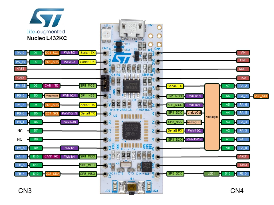

Posted on August 14, 2017 at 06:13
I am trying to get a basic project working using the CMSIS register definitions. Below is the code I am flashing to my NUCLEO-L432KC. LD3 does not light. My understanding of the demonstration board's pinout is that I should be using pin B3. I am setting the pin high to drive the LED on in push/pull mode per other postings I found (I can't view the board files at the moment).
To build this project, copy the Drivers directory out of the STM32CubeL4 or an empty STM32L432KC project created with STM32CubeMX. Also copy out the files ''STM32L432KCUx_FLASH.ld'', ''startup_stm32l432xx.s'', and ''Src/system_stm32l4xx.c''. You should then be able to compile using Make.
It is my hope that any errors are obvious without testing. Does the default code provided by STM do more initialization than is happening below? What could I possibly be missing? I have tried commenting out my clock setup to see if that was the issue. I was told to step through the code to see if the registers are set and I will try this tonight, but what if everything is set properly (as it is now, I have no reason to believe the register assignments aren't taking)?
Thank you in advance.

I changed:
GPIOB->MODER &= ~(GPIO_MODER_MODE3_1);�?�?
To:
GPIOB->MODER = ~(GPIO_MODER_MODE3) | (GPIO_MODER_MODE3_0);�?�?
After finding out the only portion of my GPIO setup that did not work was the mode setting. The MODER bits for B3 do not default to 0b
