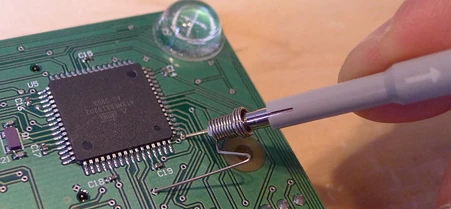

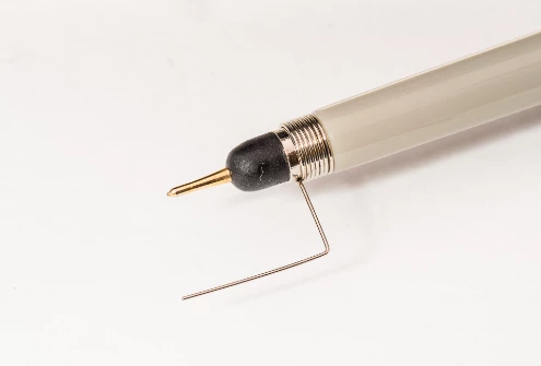

  1. ok now - basically.
  2. probe needs adjustment (square wave / overshoot , check with probe signal at scope)
  3. hi speed testing only possible with 10:1 tip at point to test and ground at metal ring on tip.
  4. line to tip gnd < 3cm from gnd on board (solder blank wire there).
  5. with "standard" long gnd line /alligator clip signal never will be "perfect" looking
like this...
https://electronics.stackexchange.com/questions/491355/oscilloscope-probe-points

AScha.3
AScha.3Best answer
May 11, 2023
like this...
LCE
Principal III
May 12, 2023
Oh boy, I didn't even expect someone to NOT use 10:1...
The GND probe point you see above should be available with each high speed probe / scope, if not, grab some silver wire and roll your own. :D
