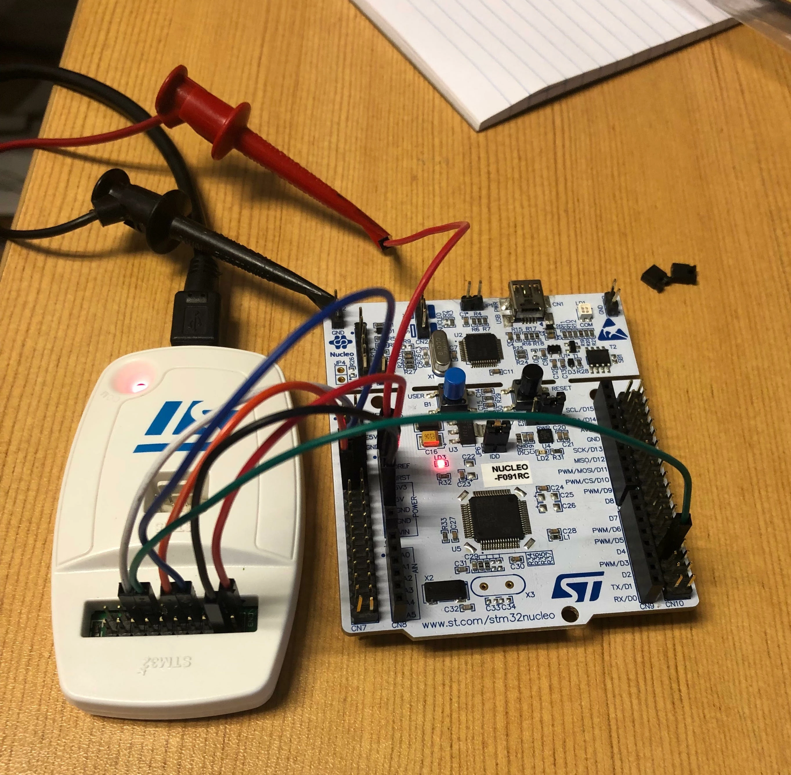

This is our first use of the ST-Link outside of Nucleo-64 board development and I was thinking it may be best to start there:
  • Board - NUCLEO-F091RC
When I hook the Nucleo-F091RC up to the external ST-Link/V2, I use the following wiring & apply 3.3V -
Config:
  • CN2 - Jumpers Removed
  • Vdd - 3.3V (CN6.4)
Board Wiring:
  • Vdd - CN6.2
  • Gnd - CN6.6
  • SWDIO - CN7.13 (PA13)
  • SWCLK - CN7.15 (PA14)
  • SWO - CN10.31 (PB3)
  • NRST - CN7.14
ICSP Wiring:
  • Vdd - p1
  • Gnd - p4
  • SWDIO - p7
  • SWCLK - p9
  • SWO - p13
  • NRST - p15

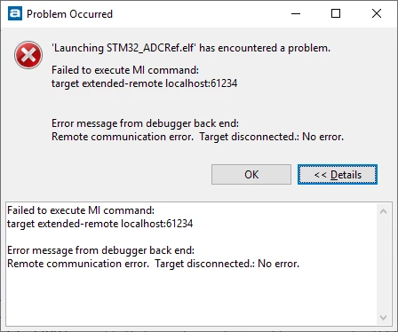

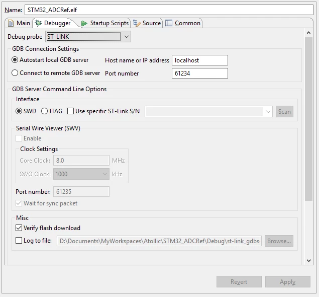

When I launch an existing project that works using the onboard ST-Link it now reports "a problem occurred", see attached. What is the issue here?

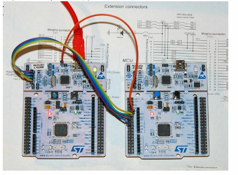

St-link part(left Nucleo)	rest of Nucleo (right Nucleo)	signal
CN4 pin 2	CN7 pin 15	SWCLK
CN4 pin 3	CN7 pin 19	GND
CN4 pin 4	CN7 pin 13	SWDIO
CN4 pin 5	CN7 pin 14	NRST
JP1 left pin	CN7 pin 12	+3V3_ST_LINK
Programming and testing programs run entirely properly in this combination. Of course, CPU power supply can be solved in another way. Here is powered from 3.3V St-link, because it is so easy for me. For this test, in the right Nucleo it is open jumper CN12 (because not powered St-link bother NRST line), but in your situation it does not matter.

Thanks Irana! I have two Nucleo-64’s and will try this in the morning, looking forward to testing this out :ok_hand:
