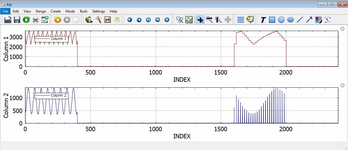

Help me understand how to fix this issues with ADC scan feature
I'm using a STM32G431 MCU ADCs in dual mode. I'm trying to get control of the sampling rate and have found a frustrating issue. I don't need to scan multiple channels. Though the only way to get maximum sampling rate, or to have any control over the sampling rate via prescaler, is to enable scan mode. That would be an acceptable work around, but scan mode introduces its own unwanted artifacts into the samples. In scan mode, though I can get the rate I want, I have the extra data from the scanned channels which I do not need.
If I don't use scan mode, the sampling rate is fixed somewhere around 300ksps which is not fast enough. Besides that, slowing the sampling rate is apparently not possible via prescaler in this case.
Any ideas how I can do these conversions, without scan mode, while having full control of the adc clock?

I've attached a picture of the data for reference. Thanks!
This limit might be given by you attempting to poll the ADC using possibly slow Cube/HAL functions.
Maybe you want to use Continuous mode and DMA.

sd.1
sd.1Author
Jun 23, 2020 3:33 PM UTC
Thanks for your suggestion. That could be the case and I will try continuous mode, seems like a good idea. But I figured, even though there is HAL overhead, the DMA should be doing its process regardless since I am only looking at conversions at DMA EOC interrupt.
sd.1
sd.1Author
Jun 23, 2020 3:44 PM UTC
Hey, thanks for the continuous mode tip, it solved my problem! I think stopping/starting the dma/adc may have been causing the issue.
