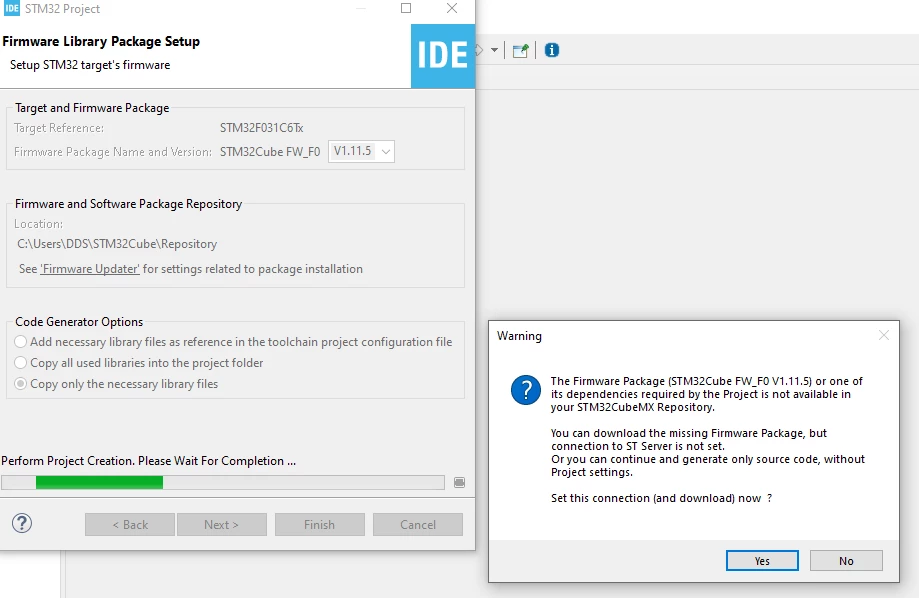

Hello, I new to STM32Cube IDE and am starting out with the STM32F031C6T7 device. My development computer at work does not have an internet connect so I must download any required software and manually install it. How do I manually install the following:
I ask because when I try to create a project for the STM32F031C6T7  device I get the following warning:
I believe it wants the file "Patch for STM32CubeF0" installed but I don't know how to do that can anyone help me please.

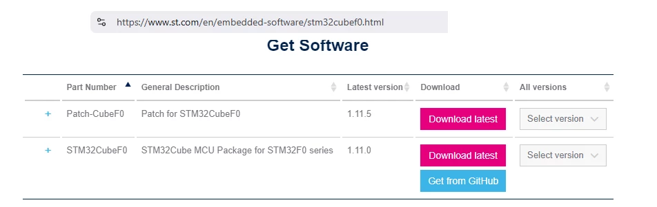

First the main package (ending with '.0') must be installed, then you can install the patch (ending with a number not equal to '.0', here '.5').
The installation can also be done manually by copying the contents of the ZIP into the repository one after the other, whereby you have to let the data from the patch overwrite some previously copied files. The IDE can then access the firmware. The package of the STM32F0 can e.g. be found here.
Hope that helps?
