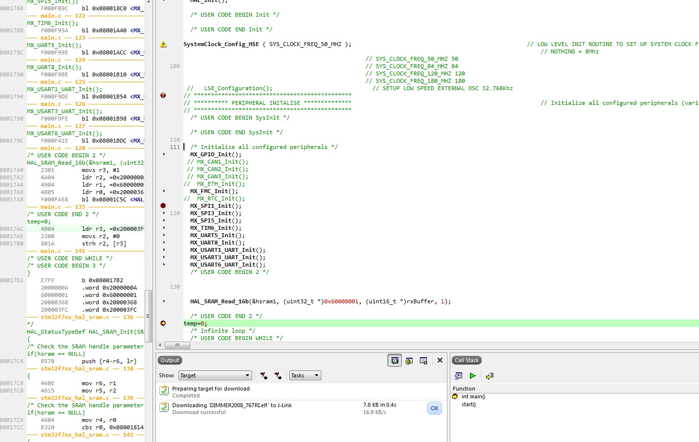

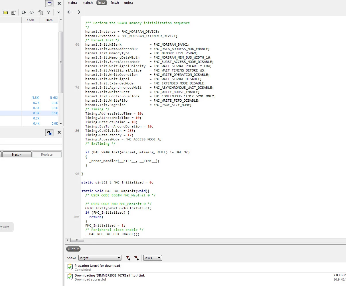

trying to work out out how the FMC peripheral works on the STM32F767ZI arm
would like to interface an FPGA to the 767 arm as an external memory device using a multiplexed Address & Data Bus, but so little info on the FMC out there ???
I have hooked up all the hardware wiring between the FPGA and ARM and guess what, as usual really really strange thing happening ?

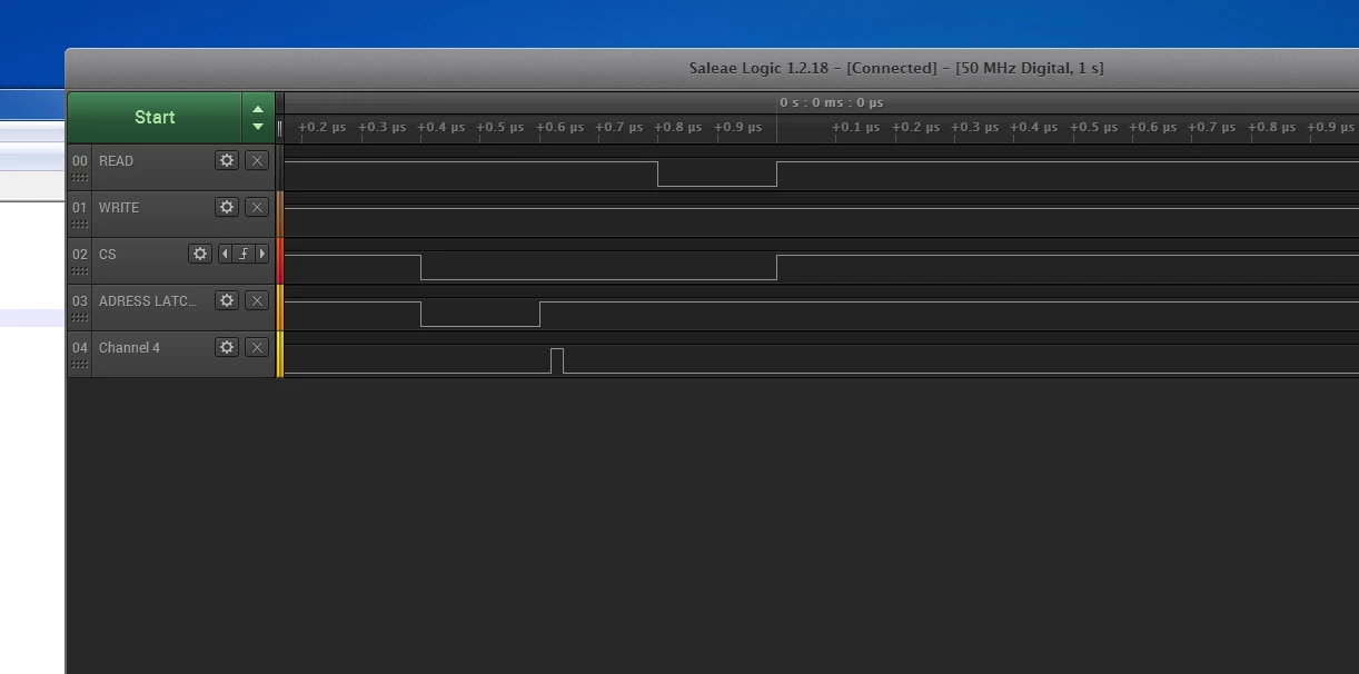

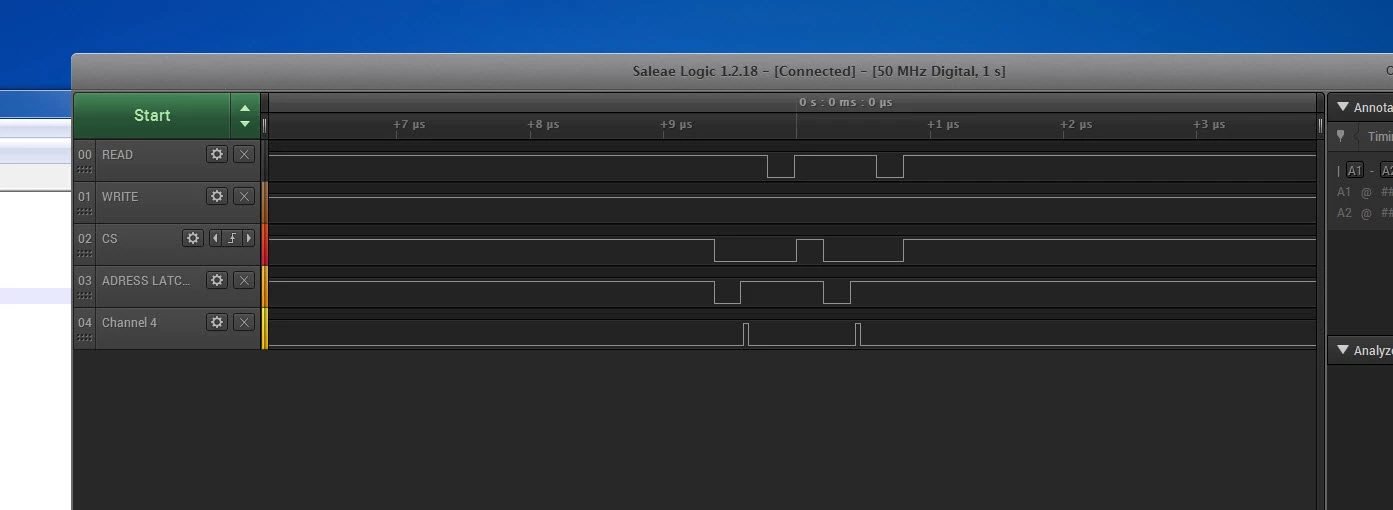

why when I use
 HAL_SRAM_Read_16b(&hsram1, (uint32_t *)0x60000001, (uint16_t *)rxBuffer, 1);
I get two chip selects and two reads
Yet when I read 60000000 I only get one CS and one read, WHAT IS GOING ON ???
 HAL_SRAM_Read_16b(&hsram1, (uint32_t *)0x60000000, (uint16_t *)rxBuffer, 1);
Both these above HAL_SRAM_Read commands should simply read back ONE 16bit (2byte) data from the selected address
but anything above 0x60000000 does 2 chip selects and two reads of the data

0x60000000 should = 1st 16bit address read
and
0x60000001 should - 2nd 16 bit address read (why 2 chip selects and 2 reads of data ??)

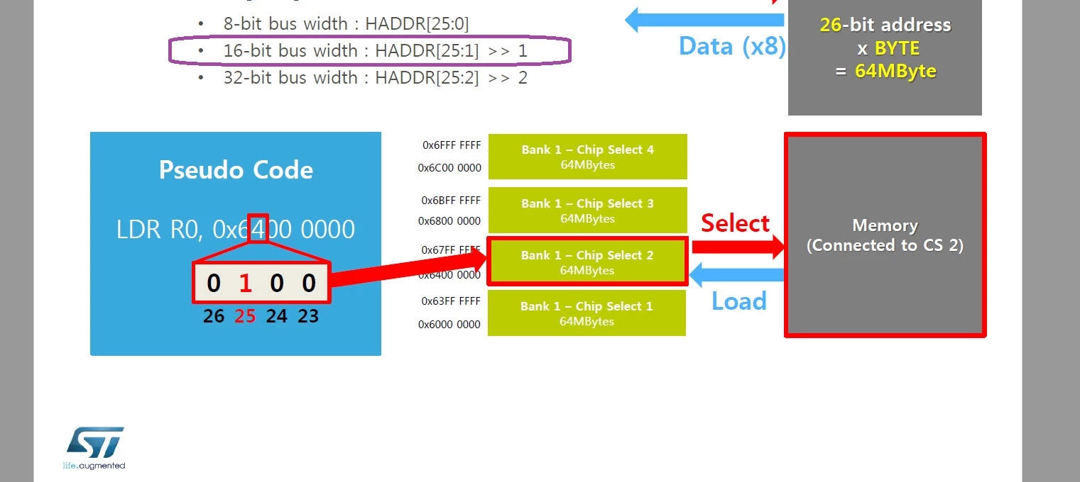

How wide is the DATA BUS?
At 16-bit the memory address to the DEVICE changes from 0x60000000 to 0x60000002
If you read a 16-bit word at an ODD boundary it spans TWO words in the DEVICE

my data bus is 16 bits wide, i'm only interested in 16 bits address so address (16:23) not intrested
so I have 16 multiplexed address and data lines which should hopefully send out the 16bit address first over the 16 lines to the FPGA and then either write or read 16bits of data from or to the FPGA

With a 16-bit DATA BUS the DEVICE addresses as WORDS
 0x60000000 = address 0 externally
 and 0x60000002 = address 1
 and 0x60000004 = address 2
>>sorry really confused are you saying it reads two lots of 8bit data consecutively thus the two cs lows ??
EVEN WORDs will go to your device directly
ODD ADDRESSED WORDs will span TWO WORDs in your DEVICE
0x60000001 will pull HALF of WORD 0, and HALF of WORD 1
BYTEs are manage via BYTE LANES. A Barrel shifter on the input to extract a 8-bit byte from the word, and a LOW/HIGH Byte Lane select for writes to a single byte within the word.

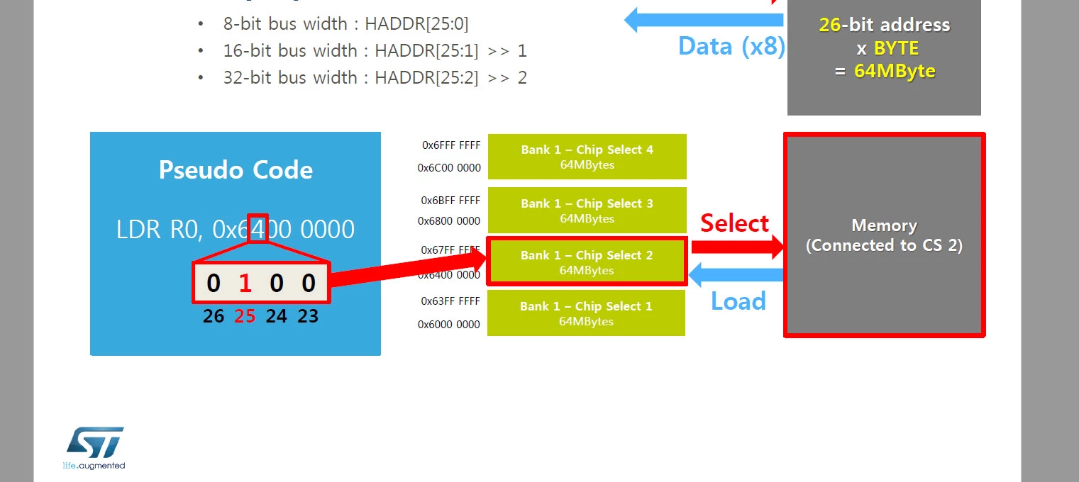

ST Shifts the Internal Address Space to the External Bus, at 16-bit, ie IntA1 -> ExtA0

YES
The processor has byte addressability, you're attaching a word addressable device, there is a translation
For uint16_t *p = ( uint16_t *)0x60000000;
*p++ = 0x1234; // Writes to DEVICE ADDR 0
*p++ = 0x5678; // Writes to DEVICE ADDR 1 (advances pointer by 2)
