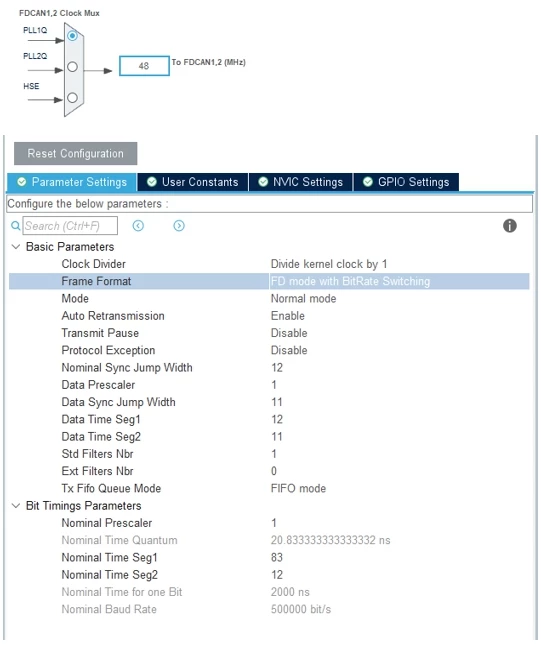

FDCAN does not work.
Please advise if there is any problem in the entire code below.
The set clock of FDCAN is 48Mhz and each setting is as follows.
_legacyfs_online_stmicro_images_0693W00000bi15kQAA.pngWhen the code is executed, Tx is transmitted once every 4 seconds in the while loop.
However, if Tx is entered about 4 times, it always falls into Error_Handler.
Error returns Error at the bottom of HAL_FDCAN_AddMessageToTxFifoQ function.

Another important clue is that if you change just one line of frameformat to FDCAN_FRAME_CLASSIC in the entire code, it will operate normally with CAN2.0 (not FDCAN).
hfdcan1.Init.FrameFormat = FDCAN_FRAME_FD_BRS; -----------> hfdcan1.Init.FrameFormat = FDCAN_FRAME_CLASSIC;

static void MX_FDCAN1_Init(void)
 hfdcan1.Instance = FDCAN1;
 hfdcan1.Init.ClockDivider = FDCAN_CLOCK_DIV1;
 hfdcan1.Init.Mode = FDCAN_MODE_NORMAL;
 hfdcan1.Init.AutoRetransmission = ENABLE;
 hfdcan1.Init.TransmitPause = DISABLE;
 hfdcan1.Init.ProtocolException = DISABLE;
 hfdcan1.Init.NominalPrescaler = 1;
 hfdcan1.Init.NominalSyncJumpWidth = 12;
 hfdcan1.Init.NominalTimeSeg1 = 83;
 hfdcan1.Init.NominalTimeSeg2 = 12;
 hfdcan1.Init.DataPrescaler = 1;
 hfdcan1.Init.DataSyncJumpWidth = 11;
 hfdcan1.Init.DataTimeSeg1 = 12;
 hfdcan1.Init.DataTimeSeg2 = 11;
 hfdcan1.Init.StdFiltersNbr = 1;
 hfdcan1.Init.ExtFiltersNbr = 0;
 hfdcan1.Init.TxFifoQueueMode = FDCAN_TX_FIFO_OPERATION;
 if (HAL_FDCAN_Init(&hfdcan1) != HAL_OK)
 Error_Handler();

Not sure if I remember the following correctly from H7 FDCAN:
I think the TX FIFO can hold 4 messages.
The TX FIFO auto-clears with certain settings only if it receives an ACK from any receiver.
So, you sure that the receiver supports bit rate switching at 2 MHz?
If not -> no ACK -> TX FIFO full after 4 messages

Thank you for your reply.
There was no problem with the code I posted.
However, the message about TX FIFO full was ignored.
And the problem of not reading the message properly was that the CAN analyzer I used had a problem reading CANFD.
