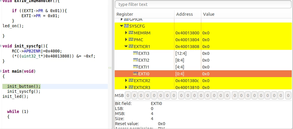

Hello!! what is wrong ? I want to do an external interrupt with button (gpio A0) to turn on the led (gpio D14) (STM32F407DISC) and do not work..
void init_led(){
RCC->AHB1ENR|=0x8;
GPIOD->MODER|=0x10000000;
void led_on(){
GPIOD->ODR |= 0x4000;
void led_off(){
GPIOD->ODR &= 0xBFFF;
void init_button(){
RCC->AHB1ENR|=0X1; //ENABLE CLOCK TO GPIOA
GPIOA->MODER &= ~0x03; // make gpioa0 mode input
EXTI->FTSR |=0x01;
EXTI->IMR |=0x1;
// EXTI->EMR |=0x1;
NVIC->ISER[0] |=(1<EXTI0_IRQn);
void EXTI0_IRQHandler(){
if ((EXTI->PR & 0x01)){
EXTI->PR = 0x01;
led_on();
void init_syscfg(){
RCC->APB2ENR|=0x4000;
(*((uint32_t*)0x40013808)) &= ~0x15;
int main(void)
init_button();
init_syscfg();
init_led();
while (1)

If you want to program like this you need to be able to user a debugger to check your work and cross check with the reference manual.
Use a shift here

MHMallek
MHMallekAuthor
Oct 28, 2019 9:39 AM UTC
thanks, this is not the problem, it seems like i forget something in the configuration.
turboscrew
Senior III
Oct 28, 2019 5:00 AM UTC
Check this: (*((uint32_t*)0x40013808)) &= ~0x15;
It seems to say : SYSCFG_EXTICR1.EXTI1 &= 0%1110, SYSCFG_EXTICR1.EXTI0 &= 0%1010
What should be left? Maybe you meant to write 15 (decimal, not hex)?
MHMallek
MHMallekAuthor
Oct 28, 2019 9:37 AM UTC
you're right, i correct it but it still not work.
