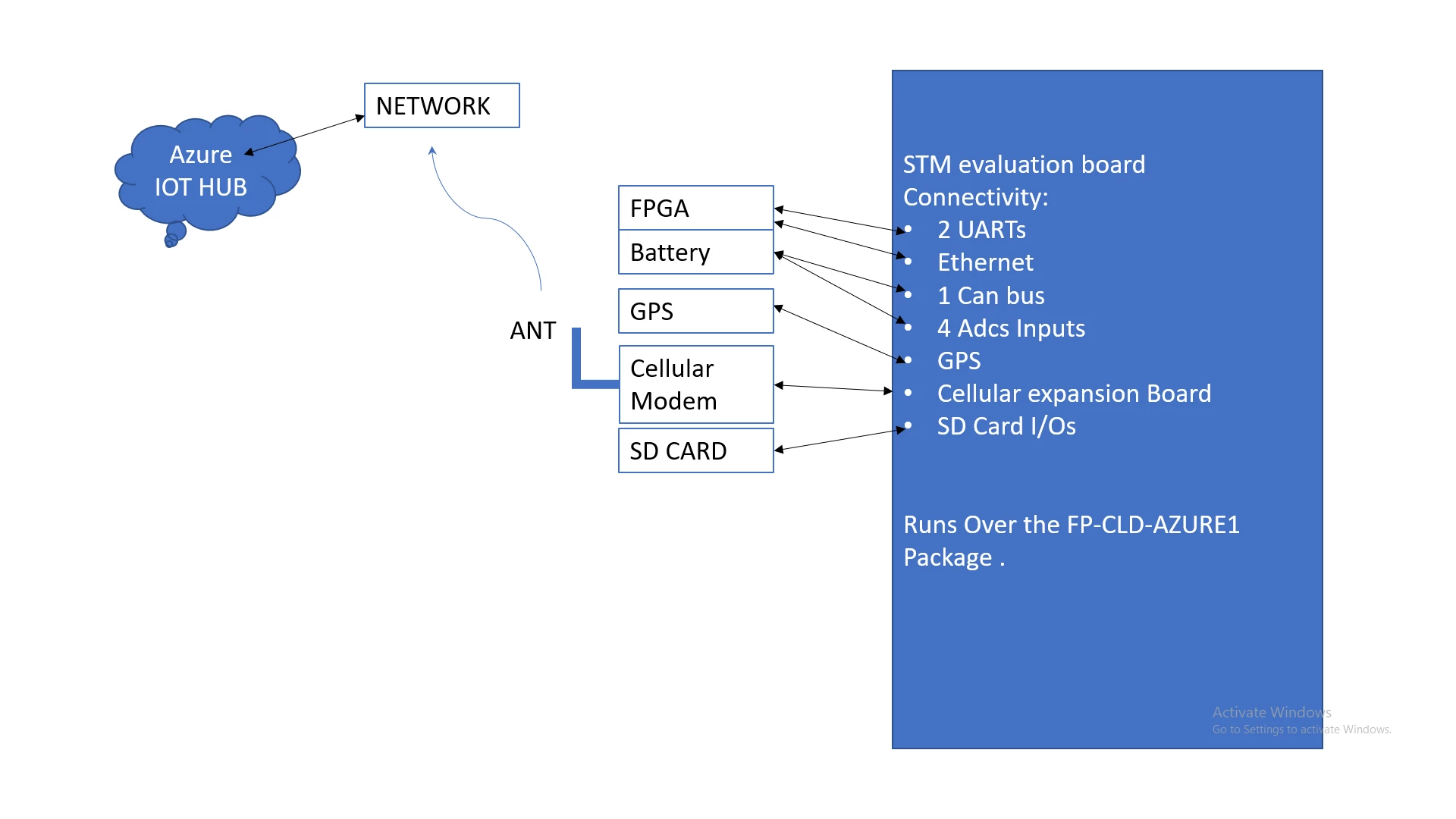

Hello, what is the best hardware configuration to implement the following project on drawing ? thanks.

    Data rates and update cycles are missing. And possibly the required manipulations of the data.
    Usually has a significant impact on controller selection.

    hi , thanks for your answer , the ADC data sampling is at 1KHz for the 4 ADCs , and the bandwidth needed is about 250Kbps . no special manipulation on data .

    Not too demanding, it seems. GPS is supposedly a serial interface, too.
    The only interface you won't find with all MCUs is ethernet, so this seems your main selection criteria.
    A F4 device could suffice, there are several eval boards available to test.
    I personally would start with the F4 discovery (+ BB extension), because it has an SPL-based demo webserver, not tainted by CubeMX.
    Keep in mind that Ethernet is critical - the "feeble" peripherals in common MCUs cannot buffer any signifcant number of frames, and will easily be overwhelmed in an average office network.
    If you want to dabble in ST's CubeMX is your decision. But read up about it before.
    From my experience, the individual requirements are not too difficult to implement, several examples are available. But balancing interrupt priorities and DMA streams to keep everything going and balanced will cost you some time and effort.

    Ethernet is on a F1, F2, F4, F7 and H7 series. F1 is old and quite different. H7 ir new and even more different. F7 (and H7) has Cortex-M7 with dual issue pipeline and cache memory, which has it's requirements for code, if used. So that leaves F2 and F4, which both seem to be more than enough. If there are no additional requirements, I would go for F2, because it's significantly cheaper.
