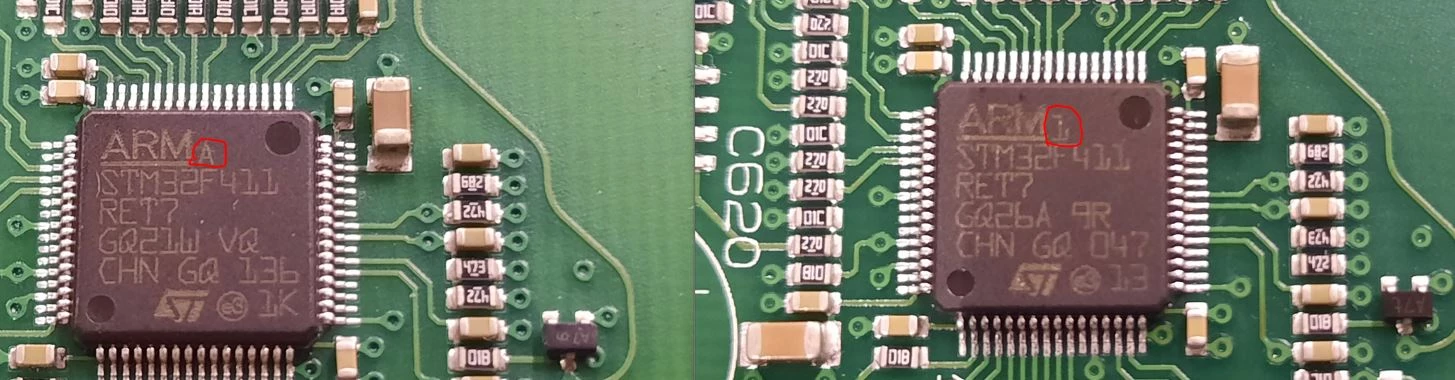

Hello, What does revision "A" and "1" mean? Please see photos. BR Krzysztof

    These are the revision codes indicating the older chip revision 1 and the newer revision A.
    Your will find details about the changes made for rev A in the errata sheet ES0287.
    Does it answer your question?
