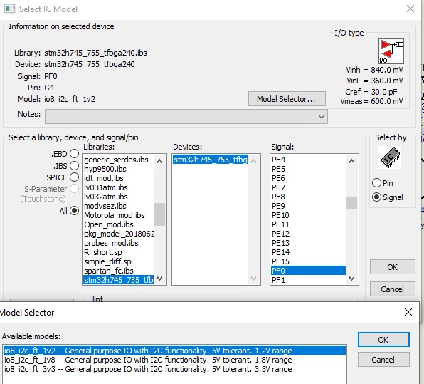

Hello, We are working with ref. STM32H745_755_tfbga240.ibis but when I select PF0 and PF3 signal in "available models" doesn´t appear "FMC_A0" model. I think is a mistake of STM32H745_755_tfbga240 ibis model? Could you help me Thank you in advance

Hello @Community member​ ,
I confirm the issue.
To solve the problem, a correct STM32H745_755_tfbga240.ibis file shared for you in below.
Sorry for this inconvenience.
