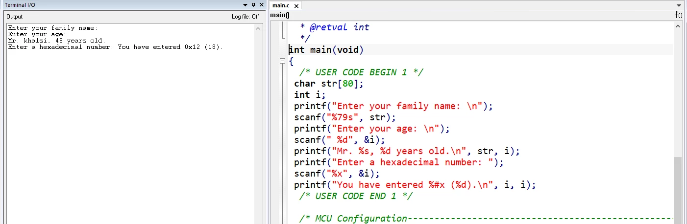

Foued_KH
May 22, 2023
the correct code would be:
scanf("%79s", &str);
Scanf did not consume the \n character that stayed in the buffer from the first scanf call.
So the second scanf call did.
You have to clear the stdin before reading again or just get rid of the newline.
The second call should be.
scanf(" %d",&i);
Foued

Foued_KH
May 22, 2023
Hello @HA.5​ ,
I have tested your code, It worked correctly :
_legacyfs_online_stmicro_images_0693W00000bka3lQAA.pngI think you should entre your inputs when debug :
Foued
