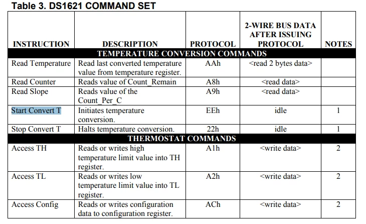

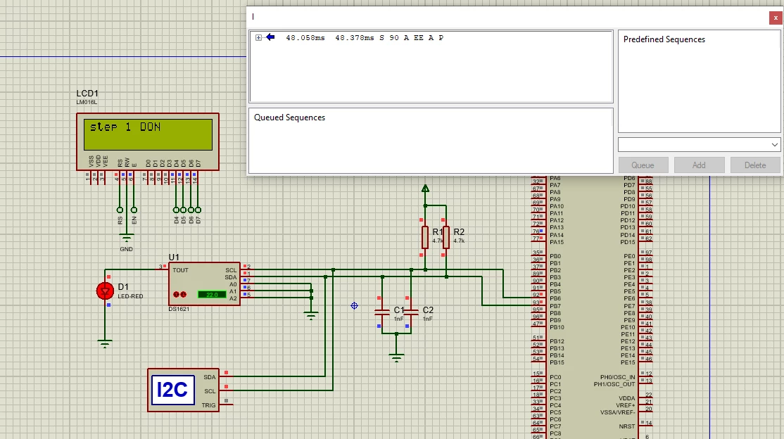

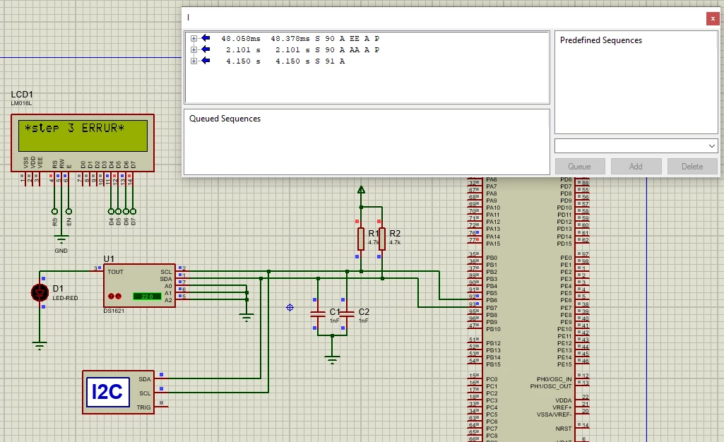

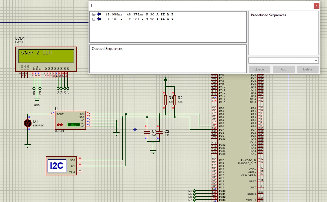

hello i'm trying to make a project whit stm32f401ve and Digital Thermometer DS1621 using I2C protocol, and I have a problem whit i2c receive. here is my source code and photos of datasheet and simulation any help will be appreciated

 buffer[0]=0xEE;
 RETURN= HAL_I2C_Master_Transmit(&hi2c1, TEMP_ADRESS, buffer, 1, HAL_MAX_DELAY);
 if(RETURN!=HAL_OK)
 Lcd_cursor(&lcd, 0,0);
 Lcd_string(&lcd, "step 1 ERUUR");
 HAL_Delay (2000);
 else
 Lcd_string(&lcd, "step 1 DON ");
 HAL_Delay (2000);
 Lcd_clear(&lcd);

 buffer[0]=0xAA;
 RETURN = HAL_I2C_Master_Transmit(&hi2c1, TEMP_ADRESS, buffer, 1, HAL_MAX_DELAY);
 if(RETURN != HAL_OK)
 Lcd_string(&lcd, "* step 2 ERRUR*");
 HAL_Delay (2000);
 Lcd_clear(&lcd);
 else
 Lcd_string(&lcd, "step 2 DON");
 HAL_Delay (2000);
 Lcd_clear(&lcd);
RETURN = HAL_I2C_Master_Receive(&hi2c1, TEMP_ADRESS,buffer2, 2, 10000);
 Lcd_string(&lcd, "*step 3 ERRUR*");

The temp sensor is a normal 1 byte subaddress memory device with auto increment to read/write.
Nothing peculiar.
