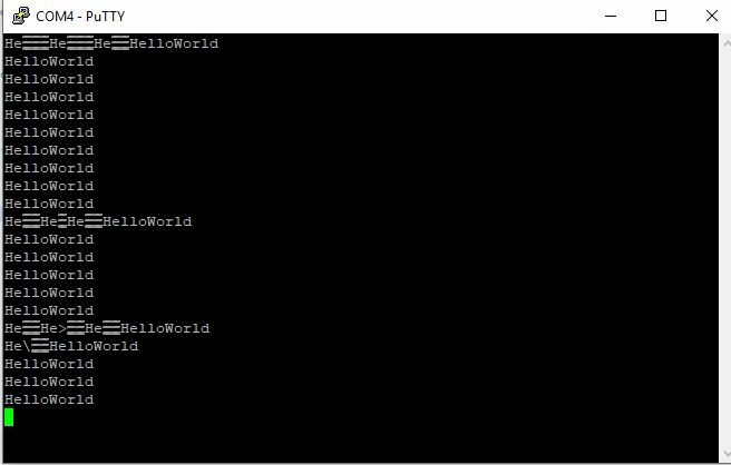

Hello, I'm new on STM32. I'm using STM32F769-Discovery for product prototiping and I am trying to use USART6 with interrupts. That's what I've:

The issue is sometimes message arrives incomplete:
Where could be the mistake?

FIXED:
As said in: https://stackoverflow.com/questions/55624428/can-we-edit-callback-function-hal-uart-txcpltcallback-for-our-convenience
HAL_UART_Transmit_IT stores a pointer and length of the data buffer you provide. It doesn't perform a copy, so your buffer you passed needs to remain valid until callback gets called. For example it cannot be a buffer you'll perform delete [] / free on before callbacks happen or a buffer that's local in a function you're going to return from before a callback call.
So I have modified EwBspConsolePutCharacter to:
void EwBspConsolePutCharacter(char* aFrame,unsigned int aSize){
	static char buffer[256];
	// Assign to buffer the frame to be sent
	for(unsigned int i = 0; i<aSize;i++){
		buffer[i] = *(aFrame+i);
	HAL_UART_Transmit_IT( &UART_Handle, (uint8_t*)&buffer,(uint16_t)aSize);
Now it's working as expected
