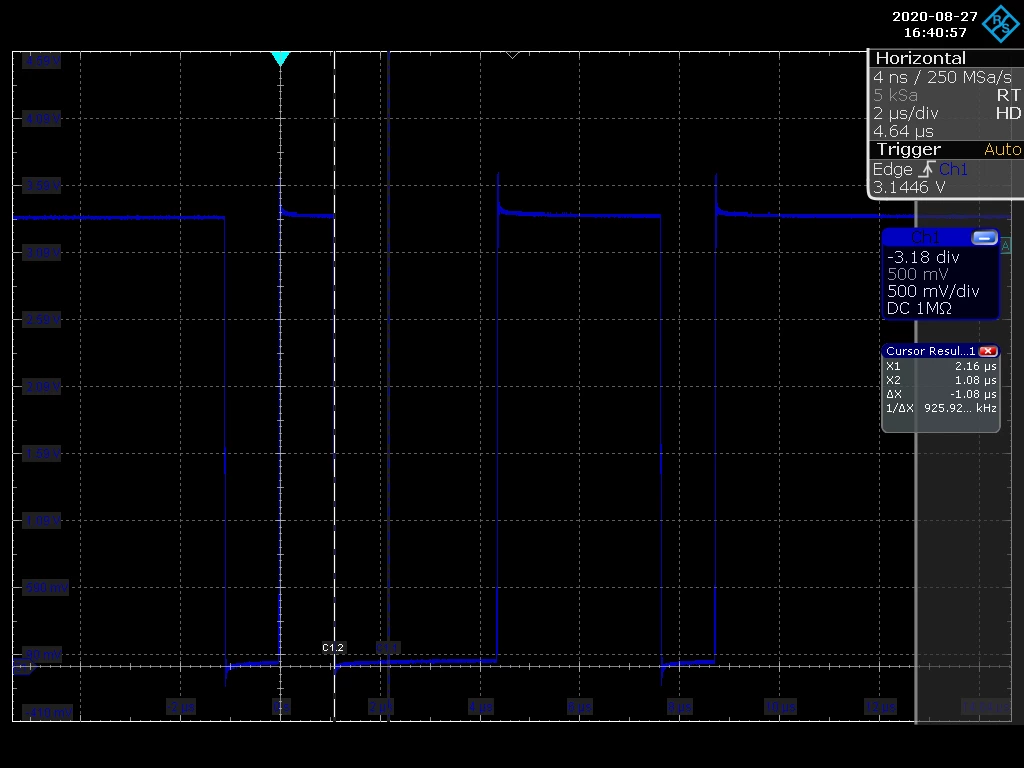

Hello, I'm having troubles changing the baudrate of my UART2 configuration. It is initially set to 921600 bps and a bit duration is 1.08us = 1/921600bps, which is fine. However, trying to double this value seems impossible.
In MX, at first, I changed the sample rate to 8 bits to double the baudrate. The code was successfully generated, compiled and downloaded. The communication still exists, but the baudrate is still the same as before, with a bit duration of 1.08us.
Then, on MX view, I reverted the sample rate back to 16 bits and introduced manually the new baudrate 1843200. The same as before happened, with the baudrate not being updated.
I tried to update directly the values on the MX_USART2_UART_Init function and the same happened, the baudrate is still 921600bps.
As I suspected this could be a rate compatibility problem, I decided to lower the baudrate to 115200bps, both on MX view and directly on the code. Again, the real baudrate remained at 921600 bps.
On my test setup, I have two MCUs STM32H745IIK6 connected together through their UART2 (no flow control and no baudrate auto-detect). One of the MCUs sends a byte constantly over and over and the other receives it and sends it back. Obviously, the changes in baudrate I preformed were on both MCUs.
Attached goes a printscreen from the oscilloscope of a byte sent (0x71), and cursors measuring the bit width.
Any ideas on what is causing this problems?

And the real baudrate with BRR set to 54 is how much?
PMach.1
PMach.1Author
Senior
Aug 28, 2020 8:11 AM UTC
It should be 1843200. It is still 921600

Trying to figure out in detail, I decided to run the code step-by-step in debug mode. It happens that in this mode I checked the BRR being correctly written (like I wanted). It ended up with the UART running in different baudrates, as ordered. Basically, it works when running step-by-step in debug, but not in normal runtime.
I decided to run it step-by-step, without stepping into that many functions, so as to not to go too low-level. Gradually, I observed that only stepping over the HAL_UART_Init() function inside MX_USART2_UART_Init() function, resuming the rest of the code to runtime mode would suffice to correctly program the UART into running. I started getting the suspicion that it was some kind of timing issue, that prevented the normal writing into the registers, although some variables were updated with the correct values (like, for example, huart2.Instance.BRR which I was checking, assuming it would correctly write the value on the register, which aparently didn't).
I came up with the workaround of adding a delay before the function HAL_UART_Init() is brought up. This *****, obviously. Now, anytime I alter the definitions in MX view and generate new code, might have to re-add the delay. My new MX_USART2_UART_Init function is as follows:
