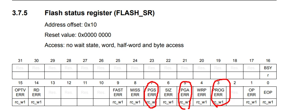

Hello i have a problem with FLASH SR REG setting up flags when i try to write in flash, im using stm32g4 wit 521kbs flash and dual banks plss help.

Here is my code : ignore the led toggles , the screenshot of the sr reg is below and highlited bits. Im guessing it has something to to with the arhitecture of the cpu.
Kind regards.

Hi skaur.1,
could you please give some more details about the FLASJ_PageErase function? I assume this function was written by you, since it is no HAL function.
When exactly get the error flags set? After the erase process, after the first call to HAL_FLASH_Program or later?

skaur.1
skaur.1Author
August 25, 2022
Hello
the page erase function is in HAL library, all it does it erases a page of memory and puts 1 into CR->PER register. the error bits begin when the function is first called and everytime after. the trouble starts when the HAL_PROG_FUN goes in to the second case of status=WAIT_FOR_THE_LAST_OPERATION().
And yea i dont know why this seems to happen. I dont se any problems with my code and I didnt touch the hal functions.
Regards,
skaur.1
skaur.1AuthorBest answer
August 25, 2022
Thanks for the effort I have found the problem I was eracing pages wrong.

Piranha
Principal III
August 27, 2022
The FLASH_PageErase() function is not meant to be used by the user code. User code must use the HAL_FLASHEx_Erase() function.
And the 3rd argument of the HAL_FLASH_Program() function is for a data itself, not a pointer to a data memory.
