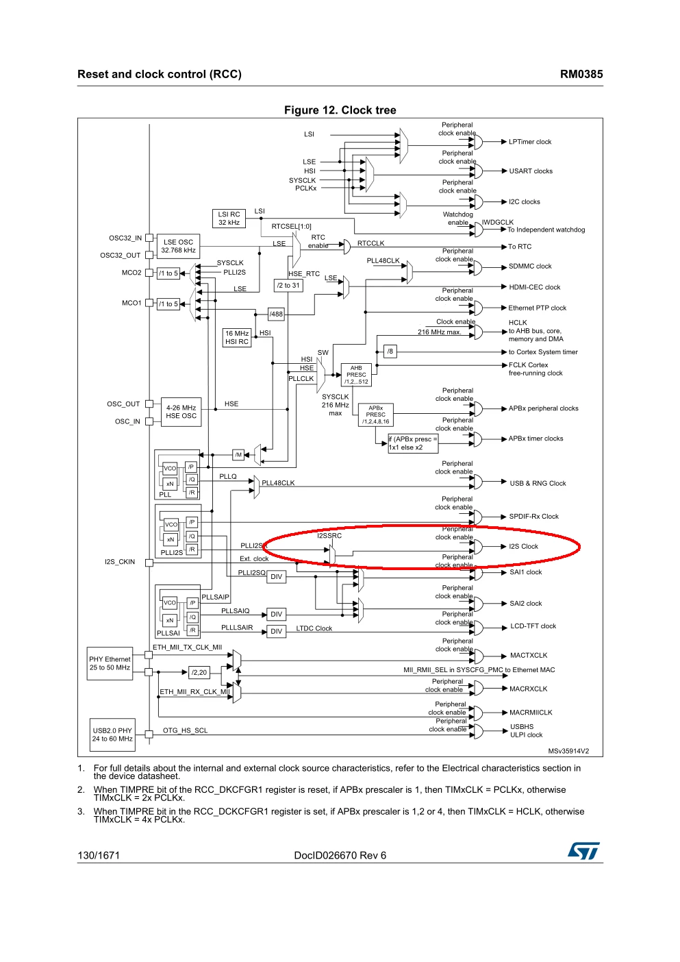

Hello I am using STM32F746 discovery board and trying to transfer data in PCM format using I2S protocol provided
Hello
I am using STM32F746 discovery board and trying to transfer data in PCM format using I2S protocol provided.
I have configured for below mentioned settings
 hi2s2.Instance = SPI2;
 hi2s2.Init.Mode = I2S_MODE_MASTER_TX;
 hi2s2.Init.Standard = I2S_STANDARD_PCM_SHORT;
 hi2s2.Init.DataFormat = I2S_DATAFORMAT_16B;
 hi2s2.Init.MCLKOutput = I2S_MCLKOUTPUT_DISABLE;
 hi2s2.Init.AudioFreq = I2S_AUDIOFREQ_32K;
 hi2s2.Init.CPOL = I2S_CPOL_LOW;
 hi2s2.Init.ClockSource = I2S_CLOCK_PLL;
after successfully configuring when I am trying to transmit the data using
ret = HAL_I2S_Transmit(&hi2s2, &dum, 1, 100);
it is giving error in
// /* Wait until TXE flag is set */
 if (I2S_WaitFlagStateUntilTimeout(hi2s, I2S_FLAG_TXE, SET, Timeout) != HAL_OK)
  /* Set the error code */
  SET_BIT(hi2s->ErrorCode, HAL_I2S_ERROR_TIMEOUT);
  hi2s->State = HAL_I2S_STATE_READY;
  __HAL_UNLOCK(hi2s);
  return HAL_ERROR;
the TXE is not setting and hence the transfer of the data is not happening within the given timeout.
Please help me out in this its very urgent

Make sure the SPI/I2S module has a valid clock configured in RCC.
0693W00000UoCBLQA3.pngIf in doubts, read out and check/post RCC and SPI/I2S registers content.

As per the cubemx the clock configurations are done as follows
PeriphClkInitStruct.PLLI2S.PLLI2SN = 50;
  PeriphClkInitStruct.PLLI2S.PLLI2SP = RCC_PLLP_DIV2;
  PeriphClkInitStruct.PLLI2S.PLLI2SR = 2;
  PeriphClkInitStruct.PLLI2S.PLLI2SQ = 2;
  PeriphClkInitStruct.PLLI2SDivQ = 1;
  PeriphClkInitStruct.I2sClockSelection = RCC_I2SCLKSOURCE_PLLI2S;
Still i could not able to transmit the data
