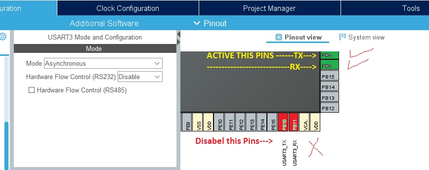

Hello, i am used stm32F767zi, i want to send & receive data by using uart3 from wir STLINKv2.1 between my computer and a card stm32f767zi. but it doesn't work, Anny one can help me please .

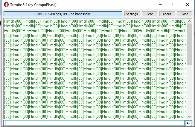

Mouzi
MouziAuthor
February 25, 2020
Hello Clive,
I try the .HEX it's wrok successfully. thank you.
The problem is resolved.
The problem is cubemxIDE really!, in first when i create uart3 cubemxIDE assigned Pins: PB10 to TX and PB11 to RX. that's why it doesn't work.
The solution is to change Pins TX and RX for uart3 :
Enable pin PD8 and choose USART3_TX
Enable pin PD9 and choose USART3-RX. ( by default now PB10 and PB11 are disable )
Now i can use STLINK-V2.1 by UART3.
 you can found in the attachment the configuration of UART3 in CubeMxIDE. and console of output message in console sending by UART3.
