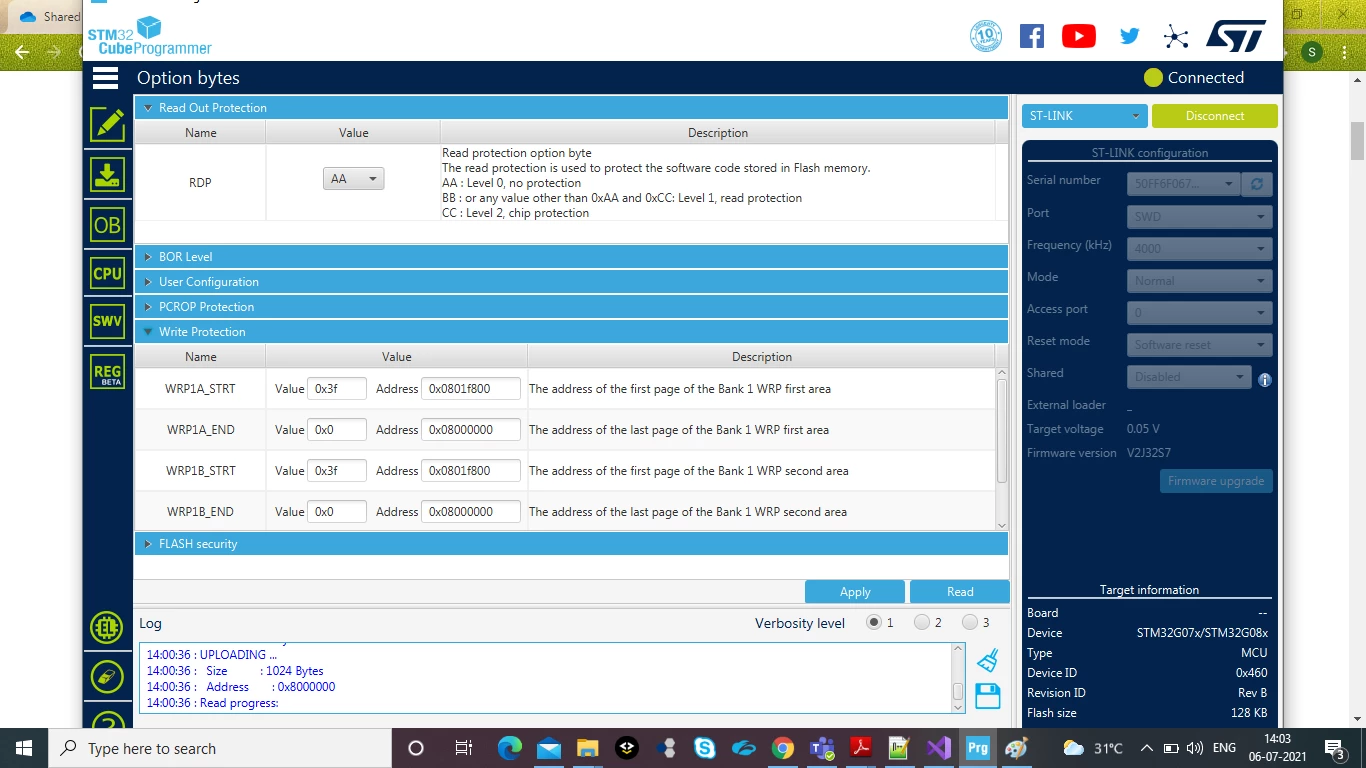

Hello, I am Firmware engineer working on STM32G07 series board. While working with Flash memory I have unprotected Flash from Read and Write using STlinkUtility v 4.5.0, after this I am not able to Erase the Flash and hence not able to Debug and load
Hello I am Firmware engineer working on STM32G07 series board. While working with Flash memory I have unprotected Flash from Read and Write using STlinkUtility v 4.5.0, after this I am not able to Erase the Flash and hence not able to Debug and load as STM32 CubeIDe internally gives Erase command to clear Flash and Writes the new code on to board, Kindly suggest how can i fix this. see attached image for details.

Hi Tesla, Thanks you for your reply !!, I have downloaded the STM32 CubeProgrammer and tried to have a full Erase from it as well, but still its not able to Erase the flash, its giving the error to "Mass Erase operation failed, please verify flash Protection". Further tried to check for the Protection but both Read and Write Protection looks disabled, please see the images which can give some clue.

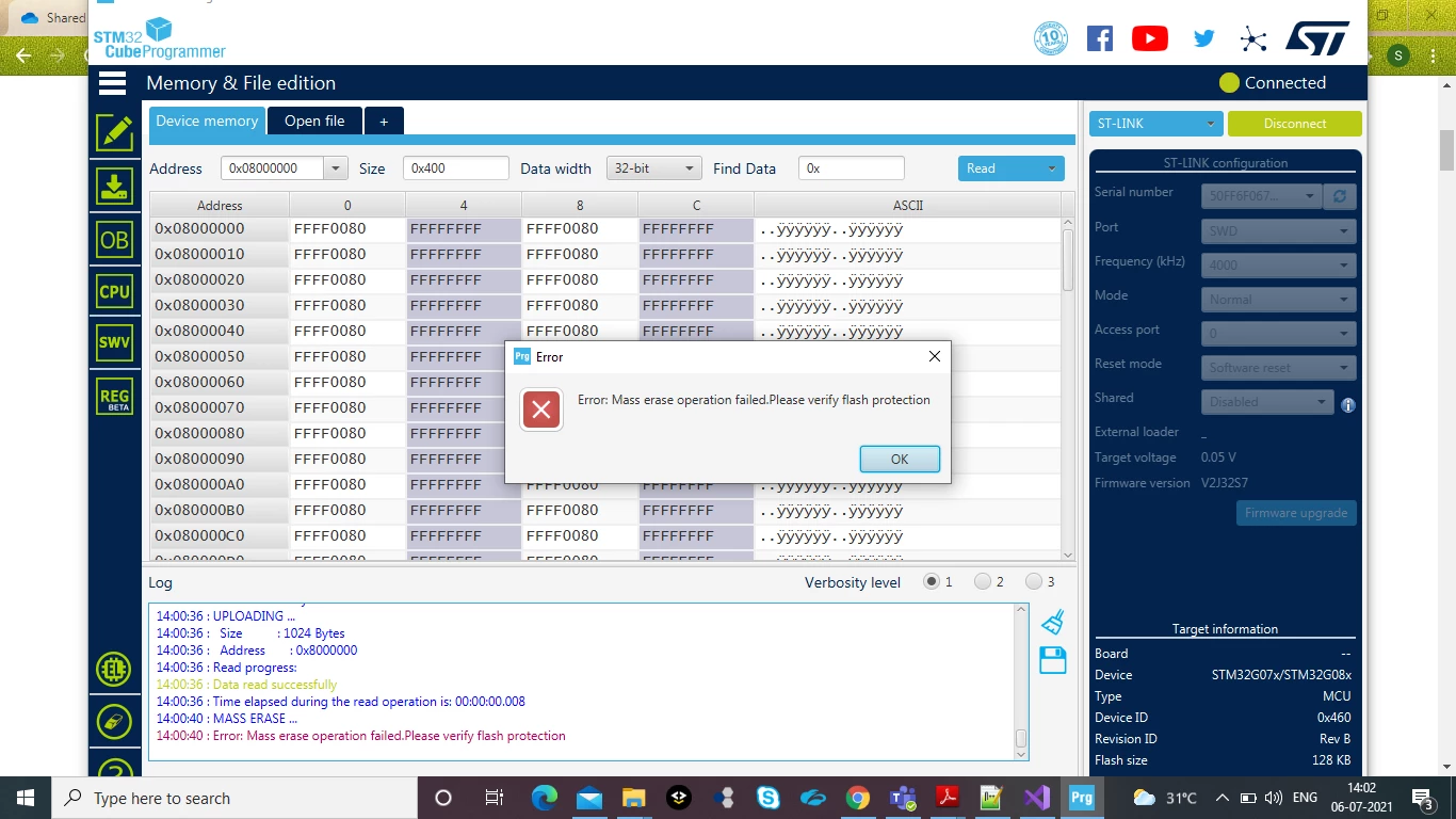

SDesh.1
SDesh.1Author
Jul 6, 2021 8:36 AM UTC
Here is another image for error
Antoine OdonneBest answer
Jul 6, 2021 8:44 AM UTC
Dear Shiv,
The Flash signature you present looks like you have PCROP activated on the part on block or all of the memory.
In order to disable it, go back to RDP level 1 and set PCROP_RDP bit in OB as well.
Hope it might help,
Regards,
Antoine
Jul 6, 2021 8:45 AM UTC
then regress to Level 0 :)

Jul 6, 2021 9:03 AM UTC
Thanks Antoine,
It worked :) Thanks for your suggestions.
